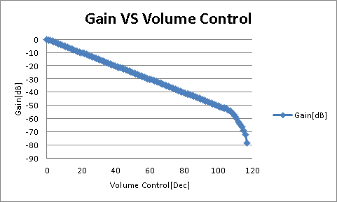

The linearity of "gain vs volume control" was degraded when setting less than -50dB as the analog gain as below, this figure is based on table 5-24 which is mentioned on page 44 of data sheet.
Could you please tell me the reason that you made such a mechanism?

    I'm not sure I understand your question. Are you asking why is there a change in slope at -50 dB? We usually do something like that as the change in output is so small at that point, that using a bunch of bits there is not useful. You want to have better granularity at the higher gains where each change is more apparent to the end user.

    The graph of "gain vs volume control" which I modified as an example is shown as below.
    I believe that it is useful to utilize gain properties of a red line for the end users, if they do not need the variable gain range from -78.3 dB to 0 dB as the analog gain control, the variable gain range from -60 dB to 0 dB with the linearity is enough.
    Could you please tell me the reason that you decided the variable gain range for the analog volume control?

    It is common to change the volume curve based on our hearing capability.
