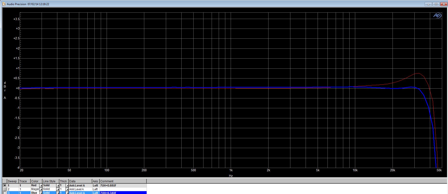

We evaluated the frequency response using TAS5558 and TAS5624A, this result is shown as below.
Since the cut-off frequency is about 36kHz(fs=96kHz), we would like to increase it more.
Could you please tell us how to increase it without changing the external LC filter?

  • Hi,Kato,
    it's not possible to change LC filter to increase the cutoff,since the cut off is limited by the 1/2fs fiirst ,and then the cutoff of LC filter.7UH+0.68UF,f0=72.9Khz;
    See here I change the cap by using two 0.68uf series,then the cap nearly comes at 0.34uf,but the cut off still keeps at 40khz.
    By the way,it has already reached 40khz. what's your concern?
    Flora Wang

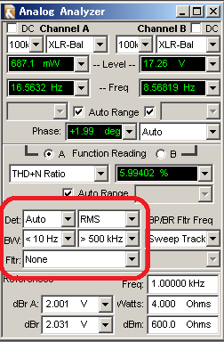

    Q3. AP Filter Settings
    Could you please tell us the AP filter settings when you evaluated TAS5624A by using the native audio processing at 192kHz?
    The AP filter settings which we used is shown as below.
    Kato
  • Hi,Kato-san,
    1.Yes,I don't remove RC filter. The RC filter will work on the high frequency ,it won't impact the 40KHz signal.
    2.I am not 100 percent sure I uesed 4ohms, just maybe.But the load don't impact the cut-off either. The load only have an impact on the Q of the filter.
    3.Yes,my AP setting is the same with yours.

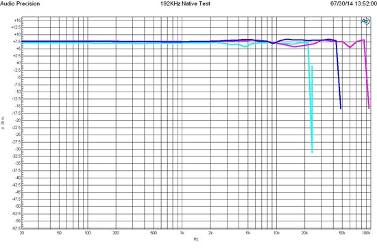

    I have tested the TAS5548 and determined that the part, as stated in the datasheet, can perform at 192KHz native processing.
    Justin
  • Hi Justin-san,
    Thank you for your reply.
    Could you please send me the AP screen capture of the frequency response at the native 192kHz processing?
    In addition, could you tell me the measurement procedure of it in detail?
    Kato
  • Hi Kato-san,
    Below is the capture of the AP output testing 192KHz, 96KHz, and 48KHz, processing. The measurement process included using the default IC register settings (the GUI has its own default register settings that it will write when the program connects to the device, they were not used for this test), from the default registers the following registers need to be changed:
    0x03: change D4 to 0 enable all channels
    0xD9: change the master volume to desired dB, for this test hex value 48, or 0dB was used
    0xC5: change to 00110001, this enables the internal clock for the sampling rate, and enables 192KHz sampling
    In addition to those changes, to verify 192KHz operation, the output filter of the EVM needed to be changed to extend past 100KHz, normally the -3dB cutoff sits around 50KHz. Furthermore, the USB input was bypassed and a 192KHz I2S signal was input straight to the IC with the PSIA.
    I have also attached the test profile for the AP.
    8156.192k_setup.zip
    Justin

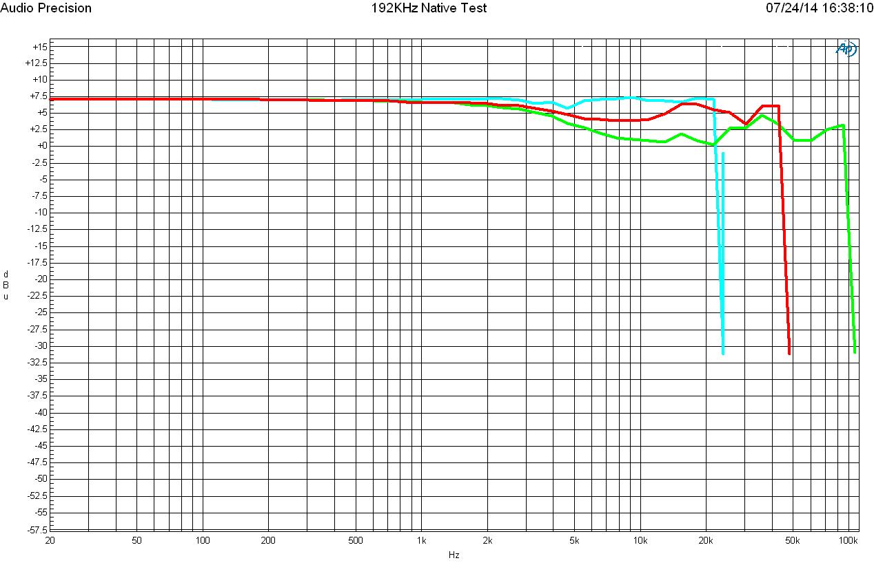

  • Hi Kato-san,
    Q1: For the external filter I replaced C34 with a 100pf capacitor and replaced C36 and C37 with 15pF capacitors.
    Q2: I do not know the cause of this attenuation, but I can investigate further. This can be fixed with the use of a biquad.
    Q3: The report I posted above was 50 steps, but I re-ran the sweeps at 200 steps and they were almost identical.
    Justin

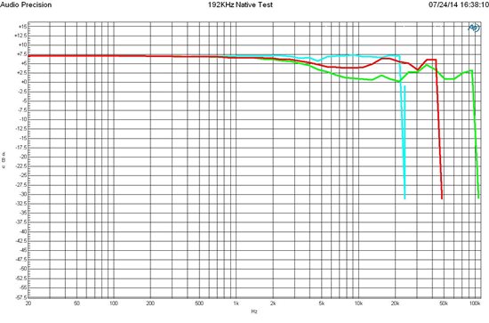

  • Hi Kato-san,
    Looking further into your questions I realized some things.
    Q1: I did not use an LC filter, but the filter on the TAS5548EVM, which is where my capacitor names cam from.
    Q2: I realized that I was measuring the wrong channel (right instead of left, left has the modified filter) so there is no attenuation, I have posted the new sweeps below, with 200 steps each.
    Justin
