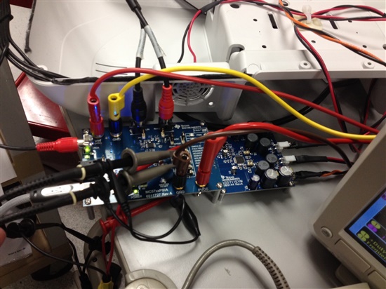

I'm having an issue getting the TAS5711 EVM working.  It currently outputs only about ~300Hz, regardless of what's on the input.  We've already verified all of the jumper settings and can see I2S data toggling into the pins of the part.  The I2C bus also seems to be working because we can turn the part on and off using the GUI.
We have it configured for 2.1 AD mode (48kHz) with 2x SE 4 ohm speakers and an 8 ohm BTL sub.
This is the second board we've tried with the same result.
What are we doing wrong?
