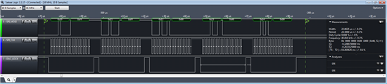

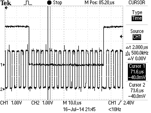

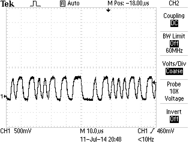

Hello all!
i have some little problem with PCM1752. It doesn't work for me.
I use it with MSP430. Sample rate 16kHz, System clock 2,048 MHz, 24 bit left justified.
But on the output I see random signal with low amplitude (sm attach)
Clock for MSP430 and (thence) for DAC I get from internal 32768 Hz oscillator (after PLL).
BCK for DAC is about 740 kHz, LR ~15,4 kHz. Could there be a problem in the inaccurate frequency? Quality of output sound isn't actual.
Thanks for help!!!
