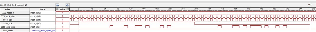

    PIcture of the waveform as seen by SignalTap/FPGA attached:
    This setting is 88.2khz, 5.64MHz bclk/mclk. I've also tried the same with 11.28Mhz MCLK.

  • Is PurePath GUI Console the current software? from http://cc.ext.ti.com/
  • Hi Brent:
    Sorry for the delay, can you please send me a picture of the modulator (TAS5558 board)? I'll have to check the schematic and see the settings.
    I also have to check the GUI and see which version is correct.Thank you,Tuan
  • By the way, the GUI link that you posted is not the right one. Please send me the pic and I can tell for sure.
