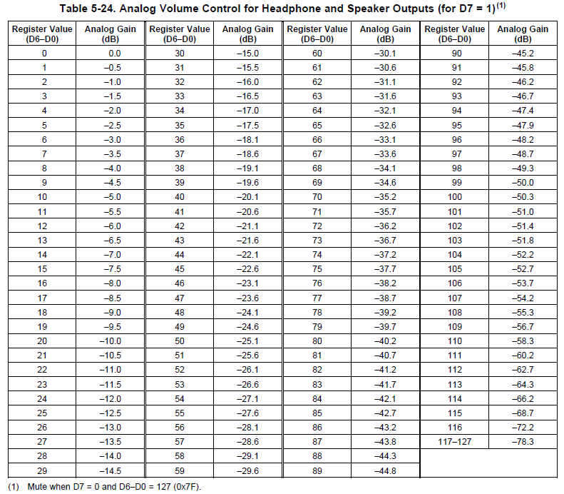

Could you please tell us the measurement method for the analog volume control of table 5-24 which is mentioned on page 44 of TLV320DAC3101 data sheet since our customer would like to know it in detail ?
In addition, could you please send us the measurement result which you evaluated since we would like to compare our measurement result with it ?
