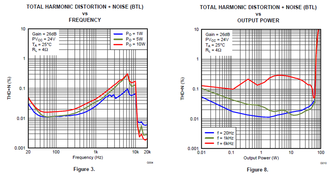

The characteristics of THD+N are mentioned for DB mode only in the data sheet of TPA3118D2, we did not find it for 1SPW mode(ternary mode).
Then, could you please send us "THD+N vs Frequency" for DB mode and 1SPW mode when using AP since we would like to compare them?
