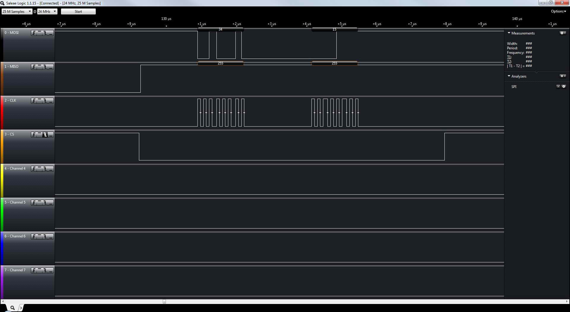

  • Hello Nate!
    Thank You for explanation! We have checked. Reg 41 is equal to 0. So, probably, signal goes into a volume control mixer (controlled by R82 page 0) before it goes to LEFT_LOP.
    We have tried:
    1) before and after problem we have read back all values, which are stored in the control registers of the codec (see please listing below). ... Values are identical and corresponds to the desired configuration of the codec. (I mean "desired" - without this parasite transfer ...);
    2) we have checked SPI interface with the codec (see please pictures below).
    Our analyser displays near a same picture, as is shown at the figure 14 and figure 15 (SPI write/read) of the datasheet. BUT! There is a pause between command and data words. During this pause SCLK pulses are not generated. Can this pause  cause problems? ... after more than 100 of successful writes ....
    We will be very appreciate for any suggestions!

  • Hello Vitalii,
    Thank you for the extra data. This is extremely useful. From your tests the most likely cause of the issue would be the routing. These devices sometimes will have routing errors if not done in a standard sequence. When changing your routing (for example disconnecting and connecting DAC_R1 to LEFT_LOP/M) we recommend to go through the entire DAC and route all the way to the output to connect and then unroute the entire change before routing something else.
    For example, to route DAC_L1 to LEFT_LOP, first unmute volume control, power up the dac, route DACL1 to LEFT_LOP, then power up the output stage and then unmute the output stage.
    To disconnect, then do the opposite commands in reverse order. So mute the output stage, power down the output stage, unroute DACL1 to LEFT_LOP, power down the DAC, mute the volume control.
    To switch routing on the fly we suggest to completely disconnect and then completely reconnect to avoid any sporadic issues. As simply toggling the routing of DAC_L1 to LEFT_LOP could cause issues.
    The same applies with routing to the ADC.
    In regards to the SPI, the pre and post error memory dump was very helpful. The fact that they are both as expected shows that you are getting good writes. Operating outside of the datasheet always runs the risk of unexpected behavior, but because your writes are good this is likely not causing the issue you are seeing. I still recommend removing the pause if possible to make sure the SPI writes are as robust as possible.
    Please let me know if you would like any additional clarification, or if this does not solve your problem,
