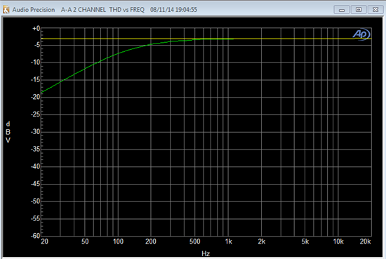

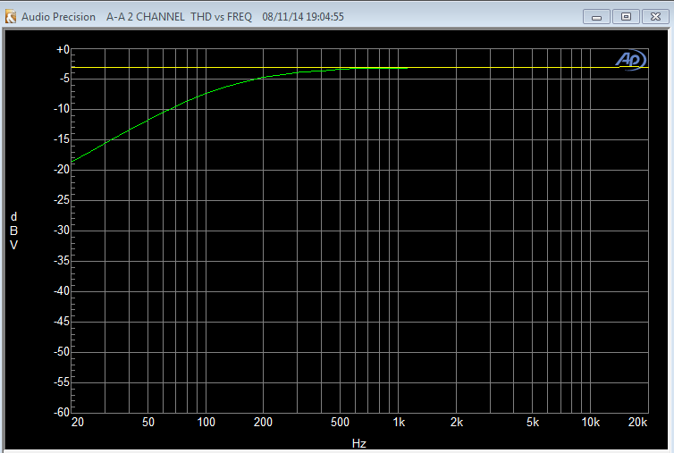

    I ran some tests today and also saw higher THD+N on the EVM. I was testing the AIC3111 which is the superset device for the DAC3101. My sweep came out a little weird but I did get a gain vs. frequency response and it showed too high of a cut off frequency for the headphone output
    The green is with 47uF DC blocking caps found on the EVM. The yellow is with them shorted.
    What happens if you short your DC blocking caps? does that solve the problem? this might suggest that bigger caps are required, though 100uF is already bigger.
    Please let me know if shorting the caps helps, if not it is likely caused by something else,
    Nate

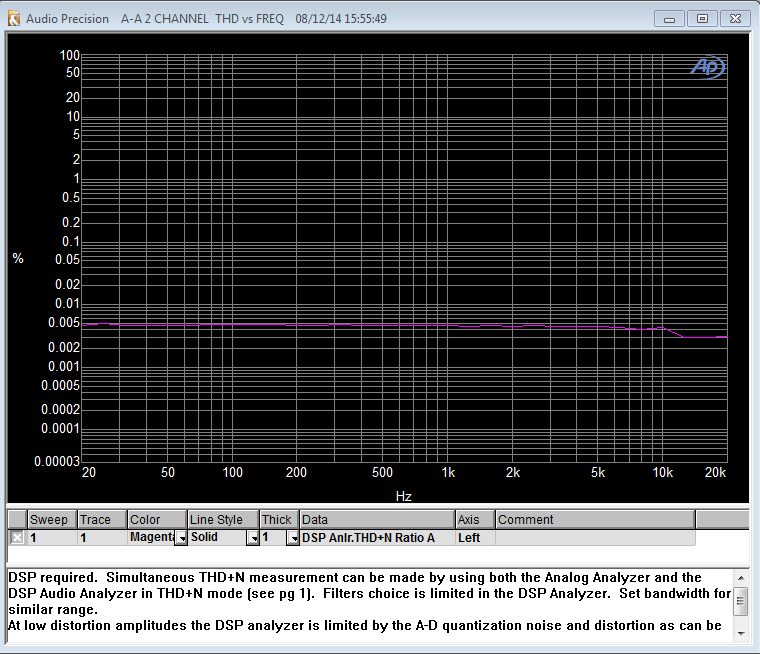

  • Hello Kato-san,
    I redid the tests from last night and got much better results by using the digital analyzer instead of the analog one on the AP. I ended up with a flat requency and amplitude response with no load but with load I can recreate your issue. When bypassing the DC blocking caps the response became flat again.
    The purple line is without load, the blue line is with 32 ohm purely resistive load and the green is with load but with the DC caps bypassed. This suggests that this distortion is caused by the high pass filter created by the capcitor and load.
    Please let me know if you need anything else,
    Nate
