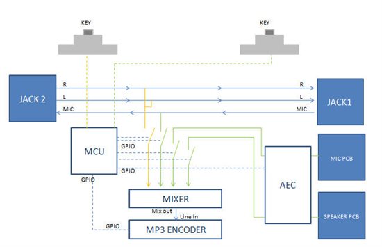

  • Hi Mat,
    I attach the block diagram of what I have in mind. There is a  MCU (probably MSP 430) commanding mixer to choose which source will be recorded by the MP3 encorder. We have mic 1 and mic 2 and earphone line as possible source. The press button on the left side will command via the MCU which source should be recorded
    1./ This is for on battery application so I wanted to verify the PCM1861 is appropriate for this kind of application and confirm how you would see this? I see the PCM familly being very rich in functionnality (hence costly..) so I was wondering if there were another IC more suitable?
    2./ I am wondering how to deal with the stereo mode coming from the line in? we don't need to record in stereo in our case (we don't care about it actually, so in this case how to deal with it), should we just pick one wire
    Thanks in advance for your time. :)
    The PCM186x family is not designated for portable applications. However, its power consumption is still very respectable at 85mW (PCM1861/3) or less for 3.3V sources. Take a look at page 9 in the datasheet to see if it meets your requirements.
    The point of using a PCM1863 is that you can use the mux and mix features to mix all of the input stereo channels into mono within the PCM1863 part. I would recommend ordering a PCM1863EVM and trying the features with the GUI.
    The issue with the PCM1861 part is it has no mixing features or fine gain tuning. Since it is hardware controlled, the part was simplified for standalone operation.  The PCM1863/5 are I2C controlled so these parts have more features and can be adjusted on the fly.
    Although these parts are more expensive, it will significantly simply the signal path since it can do everything you need in a single device.
    Matt
