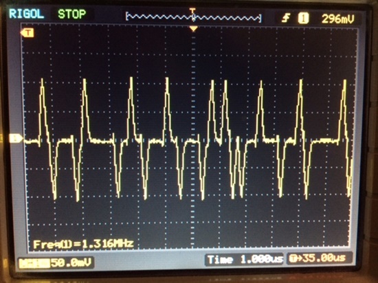

However, the fourth PCM1798 has a some nasty spikes on the output of it's I to V stage :
Now, I'm sure that I'm sending zeroes to the data line so this is something that the PCM1798 is generating itself. When I send audio data it's reproduced correctly, but with this noise on top which obviously wrecks the performance.
I've got 3 boards doing exactly the same thing so I'm pretty sure it's not a manufacturing fault. The frequency of the spikes seems to be sample rate related (they're longer at 48k than at 96k) but they're otherwise pretty random.
I'm guessing that the problem is something to do with the layout - it may not be a coincidence that the problem DAC is the one furthest from the DSP. Before I start hacking this PCB about to work out what's going on, has anyone got any suggestions of what could cause these spikes?

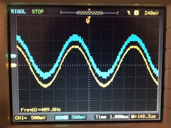

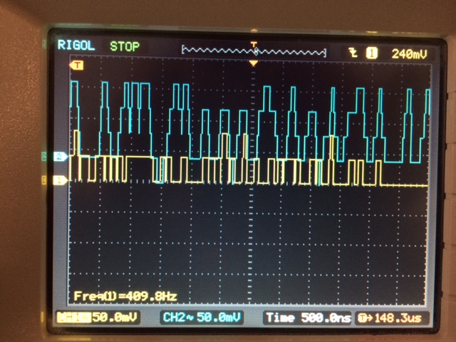

    I've modified the code in my DSP to output a synthesized 200Hz sine wave to see if that gives me any more information and this is what I've come up with. This is the output of the IoutL- pin after the I to V stage on a good channel (yellow) and a noisy channel (blue) :
    When you zoom right in, this is what I get :
    To me that looks pretty conclusively like it's the PCM1798 which is generating the noise. The question is why?
    I'm not sure I know enough about the internals of the DAC to be sure, but instinct tells me that this is more likely to be on the analog than the digital side. Have you any ideas what would make these two DACs with the same digital input give such vastly different outputs?
