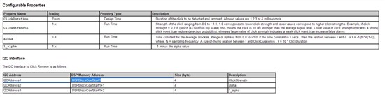

I'm using PurePath studio and i would like to use Click Remove Component for my TLV320AIC3254 CODEC.
When I use the help mode of this component , it is written :
I dont know what is the DSPBlockCoefStart1,2,3
2CAddress1
 DSPBlockCoefStart1
Could you please give me the adress that i need to write in my codec configuration in order to lauch the miniDSP and to configure the clickstrengh and clickDuration.

  • HI Matthieu,
    Click the component and look at the Properties window on the right hand side of PurePath Studio (if not visible, click on View on the top toolbar to unhide it). Then expand Component Interface. You will see Coeff=X. Expand the Coeff and it will show the Page and Register location (if you right click, you have the option to change between hex and dec). This will be your starting address.
    For example, if the starting address is Page 44, Register 8, then:
    Register 8, 9, 10, 11 would store ClickStrength.
    Register 12, 13, 14, 15 would store alpha
    and so on...
    Each coefficient is 4 bytes (3 bytes with 0x00 padding for the LSByte), as shown on the table.

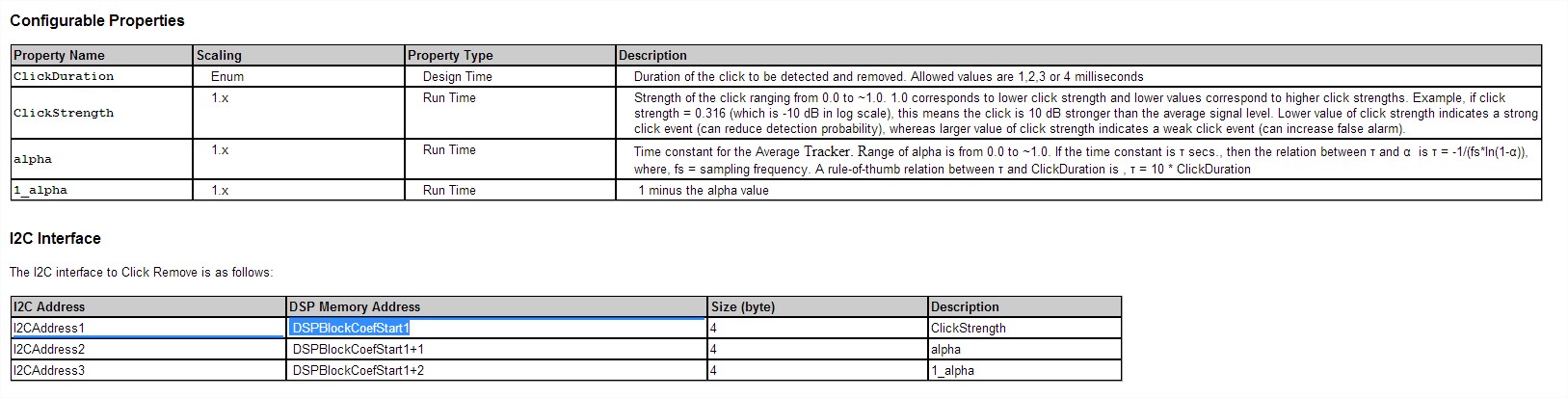

  • hi,
    Thanks for your answer . I can see the coeff, the Page and the Register Location, it's okay for that.  However, I don't understand one thing. I would like to change the duration of the Click Duration, by example from 1 ms to 4 ms. It's very sample by clicking but I don't see any modifications on the coeff in the properties.
    How can i see that the modification of the click duration ?
     Thanks.
  • I have tried to insert the coefficients in my code but i dont see any differences. I have always packet lost and there is no click remove.
    I would like to know if in addition to click_move coeff (for click_strengh, alpha and 1_alpha) i need to add some others registers, maybe a instruction in order to power up the miniDSP or something else that I dont notice.
    Thanks.
    ClickDuration is a Design Time property. This means that it will be compiled as part of the code and cannot be modified during runtime.

    For a component you have:
    1. Design time properties
    2. Runtime properties
    Design time properties are properties that cannot be changed on the fly and will become part of the instruction RAM.
    Runtime properties can be accessed through the coefficient RAM. Refer to this wiki page for more details http://e2e.ti.com/support/data_converters/audio_converters/w/design_notes/367.how-and-when-can-the-c-ram-and-i-ram-of-the-aic3254-minidsp-be-accessed.aspx.
