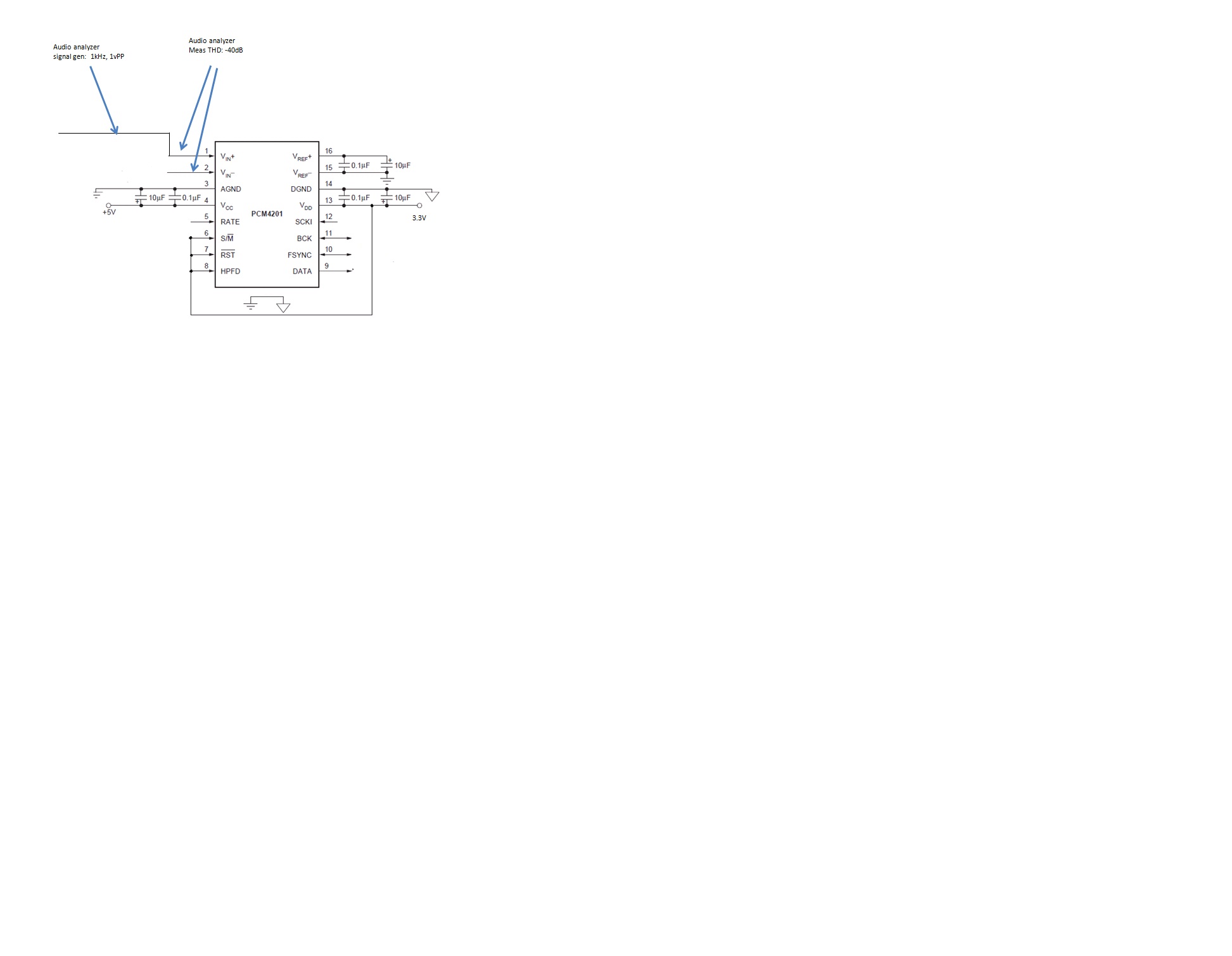

  • I am currently trying to convert a single ended 1Khz 1Vpp sine  with an -85dB THD using the PCM4201. After processing the digital signal, I am only able to  get  about -60dB THD.
     I used the single ended to differential circuit suggested by the PCM4201 data sheet.
    Using an external audio analyzer, it appears that the source of the extra signal distortion happens just at the differential inputs of the PCM4201. The analyzer's sine signal degrades to -40dB simply by tapping into the input pins. Is there anything i am doing wrong in my setup? (drawings attached)
