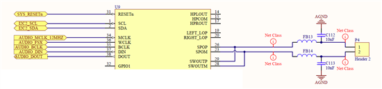

i'm working on a custom board based on an AM335x and a TLV320AIC3107 (class-D amplifier)
My device tree seems OK since the Alsa soundcard gets detected (You'l find my kernel initialisation log attached)
I can hear a breath when i try to play some sounds that could indicate that the class-D amp. is powering through I2C, but i can't hear any sound from the speakers.
Here is what i get when i do a "speaker-test -c2"

If i look at kernel log, i can see:
ALSA sound/core/pcm_lib.c:1945 playback write error (DMA or IRQ trouble?)
The driver i'm using is the one for the TLV320AIC3007 under TI kernel 3.12.10 is it OK for the TLV320AIC3107 ?
Do you have a track i can follow to find what i'm doing wrong ?
Thanks in advance for any help.
Best regards
Here is my schema and device tree:

  •  Thanks for the link Don, it helped.
    I managed to make it work, my pinmux direction was wrong, here is the correct one:
        0x1ac (MUX_MODE3 | PIN_INPUT_PULLDOWN)      /* AUD_DOUT */
        0x1a4 (MUX_MODE3 | PIN_INPUT_PULLDOWN)      /* AUD_WCLK */
        0x1a0 (MUX_MODE3 | PIN_INPUT_PULLDOWN)      /* AUD_BCLK */
        0x1a8 (MUX_MODE3 | PIN_OUTPUT_PULLDOWN)     /* AUD_DIN */
    Then i had to change Left DAC Mux to DAC_L1 with Alsamixer and i can hear a sound from my speakers !
