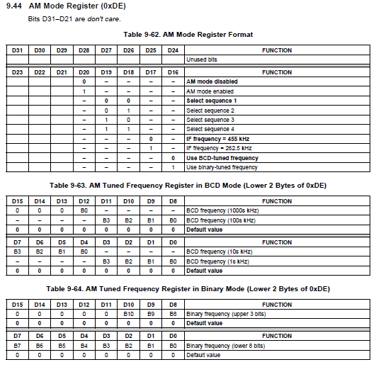

TAS5534 AM Avoidance
Could you please tell us the operation of the AM avoidance in detail since we can not understand it which is mentioned on page 107 of TAS5534 data sheet?
In addition, could you please share the application note to us if you have it?
