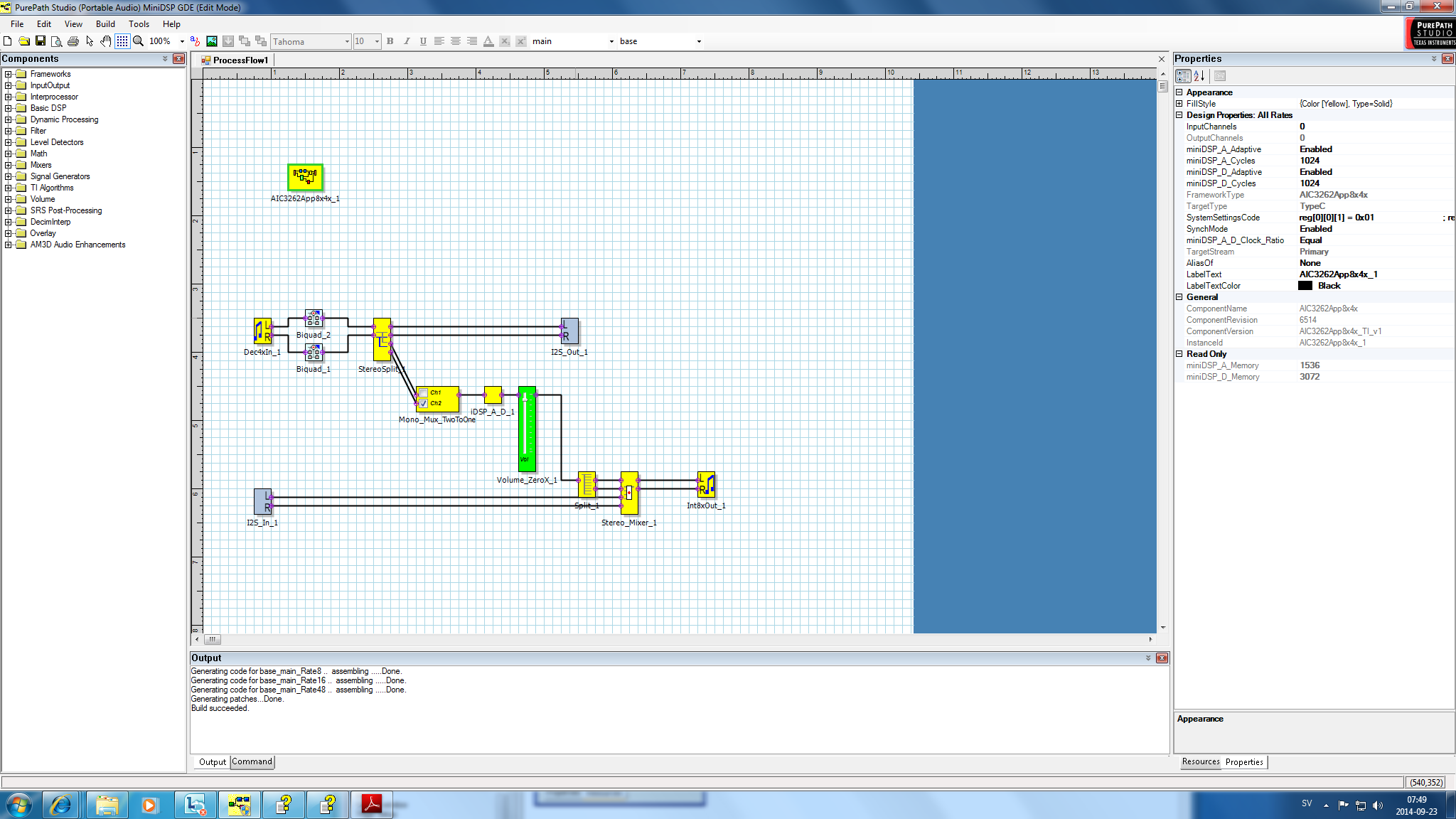

TLV320AIC3262 side-tone latency
Other Parts Discussed in Thread: TLV320AIC3262
We are using the Mini-DSP in TLV320AIC3262 to generate a side-tone, the implementation is according to the figure below. We have measured a 6ms delay of the side-tone from microphone to speaker. This is a bit more than we expected. Could the delay be introduced by some buffering in the inter DSP communication or somewhere else in the implementation? If so, what do we need to change to get lower latency of the side-tone?
Best regards
Björn Qvarnström
