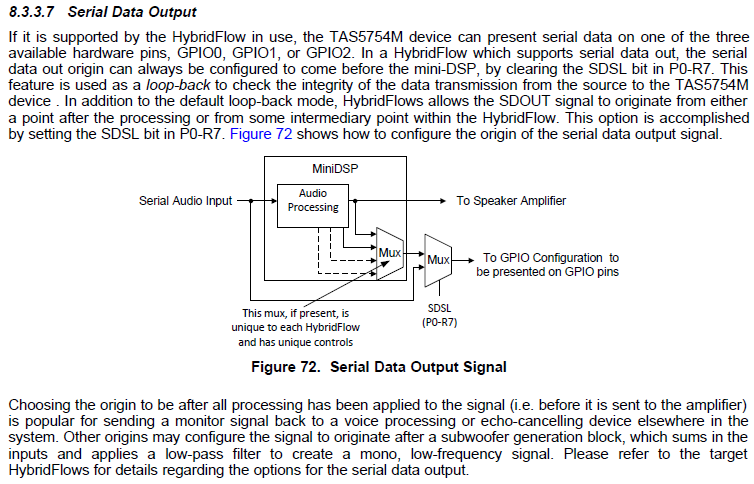

The serial audio data is able to be output as SDOUT via GPIO pin so that it is mentioned on page 50 of TAS5754M data sheet.
However, it seems that we can not freely select "Serial Audio Out" via "Source Select" with the gui of TAS5754M as below.
So, can we freely use it to verify the audio data in the future although it is depended on the target HybridFlows?
It seems that this function is used with the 2.1channel mode, however users can not set it.
