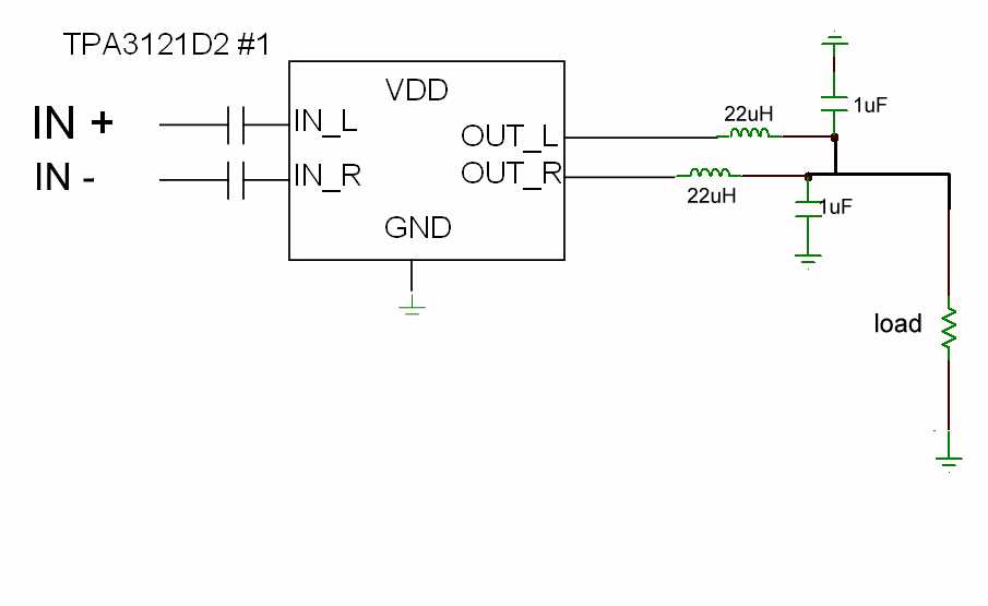

    I tested two TPA3121 devices in BTL today and I was able to achieve 60W at 10% THD into 4 ohms, 22V PS. I also measured higher output noise (250uV) compared to normal BTL (125uV). I think this is due to the parallel outputs adding current noise. I'll go back to the lab tomorrow and see if I can improve the noise performance. Please see attached file to see a high level schematic of what I tested. The way I designed the circuit makes clock synchronization a non-issue. Let me know if there are any differences between your circuit and my schematic so we can see what is causing  your problems.
    Andres Blanco
    TPA3121_PBTL.pdf

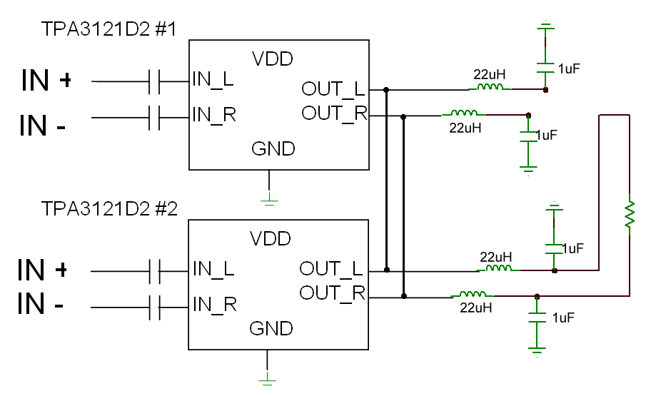

  • Hi Martin,
    I noticed on your schematic that you are shorting the outputs before the filters. Is this schematic correct? On your original post you said you were shorting the outputs AFTER the filter, which is the correct way. Which one were you trying?
    Andres Blanco
  • Hi Andres,
    i made a mistake in my drawing. I have shorten the outputs after the filter.
    I have connected the amplifiers now after youre schematic but the problem seems the same. There is some noise around every 500ms at the output speaker. Sometimes i get the correct output signal for a few seconds.

  • Hi Andres,
    i will send you my schematic and a waveform.
    parallel single ended:
    Before i built it up, is this correct or have i understood something wrong?
  • Hi Martin,
    Do not put differential inputs, since you are shorting the channels at the outputs. Instead feed the same signal to both inputs. I have attached a corrected version.
