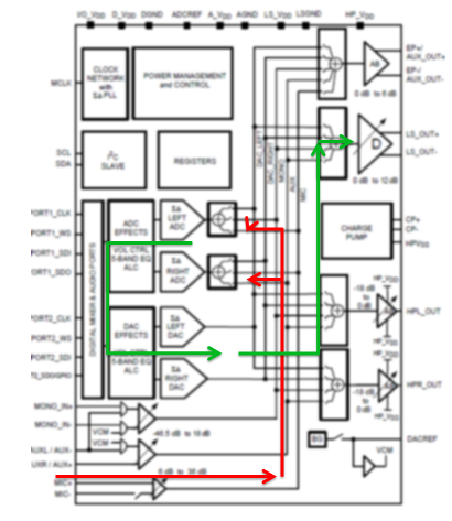

After power up , there is a pair of identical 300KHz square wave  at LS+ and L- (measured against ground). We believe the Class D is functioning ok as well. As specified by the data sheet on page 39
When we send in the data via I2S port 1, there is no output from the speaker. The waveform taken is unchanged from above paragraph, we assume there is no output from the DAC upstream (including the port 1 mux or the i2s “de-serealiser etc”.
We tried to by pass the i2s portion by trying to use MIC in, ADC, mux back to DAC (thru the digital mixer), to LS. It did not work as well. No sound(or correct switching waveform) was observed at LS output.

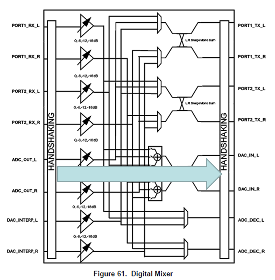

    Can you help us do a quick export of registers for below senario
    ·         Port 1 to Port 2 (SPI) loop back via the Multiplexer, OBJ: to check if the I2S setup is correct
    ·         Port 1 to Port 2 (SPI) loop back via DAC and ADC, OBJ: if I2S is ok, did we set up the ADC and DAC correctly
    ·         Direct MIC drive to LS +/- , OBJ : Is the analog path working. This test is independent of i2S

  • OK I think for the debug you need to start with the defaults and enable each block one at I time.  I am using a Audio Precision on Port1.  I power on, Set the correct rates for Audio Port1(0x50-0x56) enable port1 to the DAC(0x44) and route the dac to the LS or HP(0x10 or 0x11).  It works.  I am not using the PLL.  I see you have the PLL enabled.  Why is that?  If there is a reason please supply the clock rates you are using to I can reproduce.  I tested with MCLK=12.288, BCLK=3.072, L/RCLK=96k and FS=48khz.
    Something I did notice is that when I changed the PMC clock from MCLK to Internal OSC like you have the audio stream stopped over the PORT.  can you try setting this back to the default MCLK and /by 40.5?  If I just routed the AUX to HP/LS I could use that clock.  Also if I ran the DAC path clock from Port1 vs MCLK it worked.  So maybe this is the source out your no audio.  BTW you cannot route the mic to HP/LS directly in the analog mixer.
    I also ran mic->ADC->DAC->LS and it worked.  But again I am not using the internal PLL just MCLK.

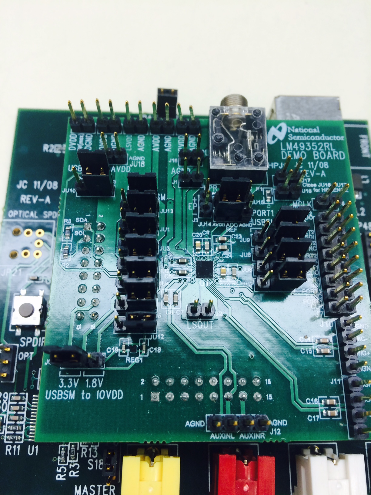

  • HI Matt
    I have one of the board.
    Can i check with you on your jumper settings for both the USB Subsystem Motherboard and the LM49352RL Demo board?
    What is the OS you are using to run the LM49352 I2C interface software V1.0 ?
    I am getting an error of
    " an error has occured in the initialization of the LM49352 I2C interface"
    Ivan

  • The software will only run on windows xp.  Attached is a picture for the jumper settings to allow the device to run completely over USB.  If the ADC ref is not setup as below it will not work over USB I found.
