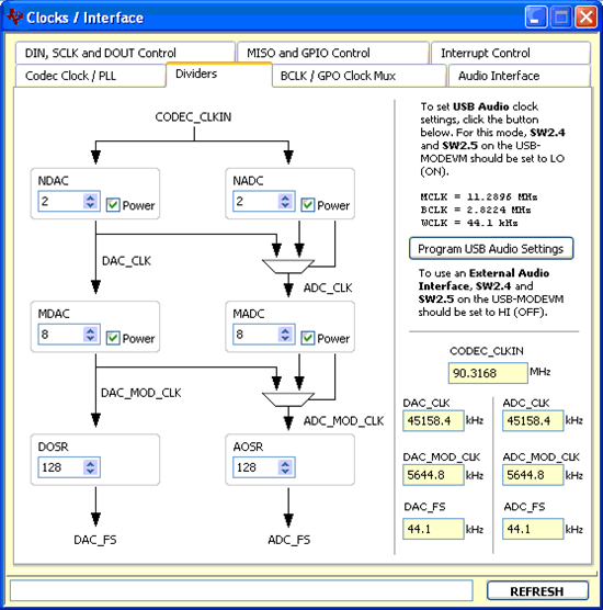

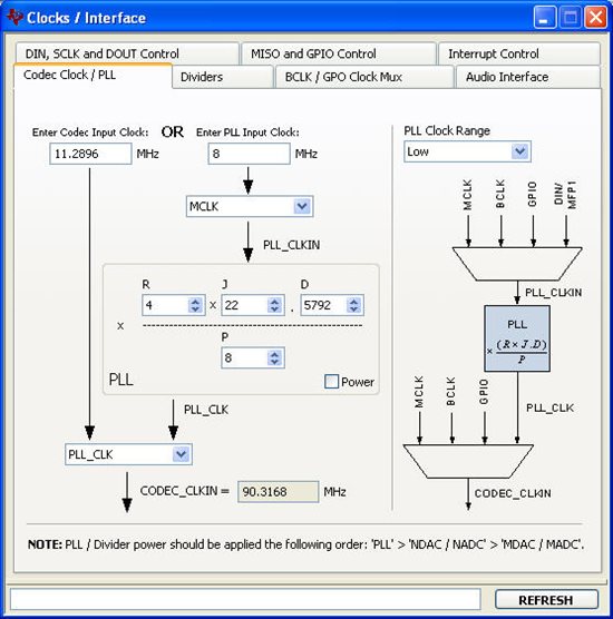

The only thing we can think of is that we have a clock mismatch somewhere?
Our clocks are set up as follows:
The script file that we were trying to run is:
