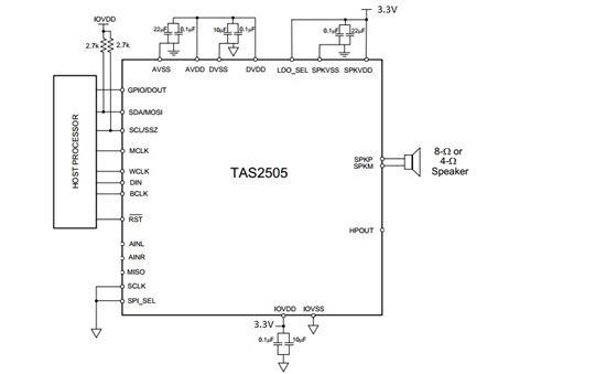

We have a board populated with TAS2505 and have the I2C analyzer to generate and capture the command and responses respectively but look like the amplifier is not responding. How to confirm its working?

Are you saying that the I2C is not ACKing any writes or it is ACKing and just not doing what you expect?
Do you have any scope shots of an I2C transaction? The schematic looks ok to me.

If the device is not ACKing, it sounds like there must be a very fundamental problem. Have you tried looking at each pin to verify that the correct voltages are present? Assuming that the device is powered properly, it should be ACKing I2C commands.
