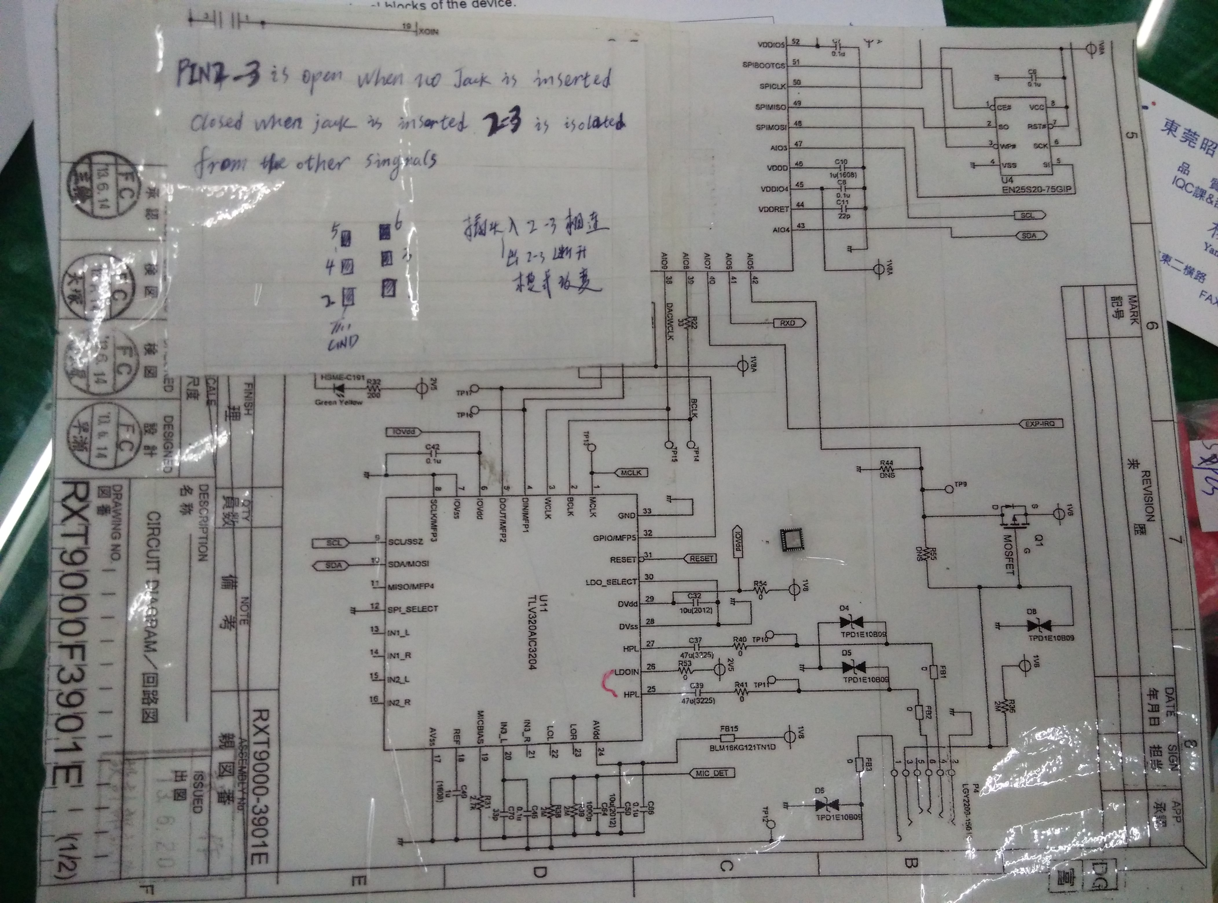

  • Hi GU,
    You'd have to ensure that Absolute Maximum Ratings are ensured for this part, especially for pins that connect to the outside world. Yes, I would suspect either EOS or ESD. Can you post the schematic portion that shows the HPL output and any other circuitry associated with it?

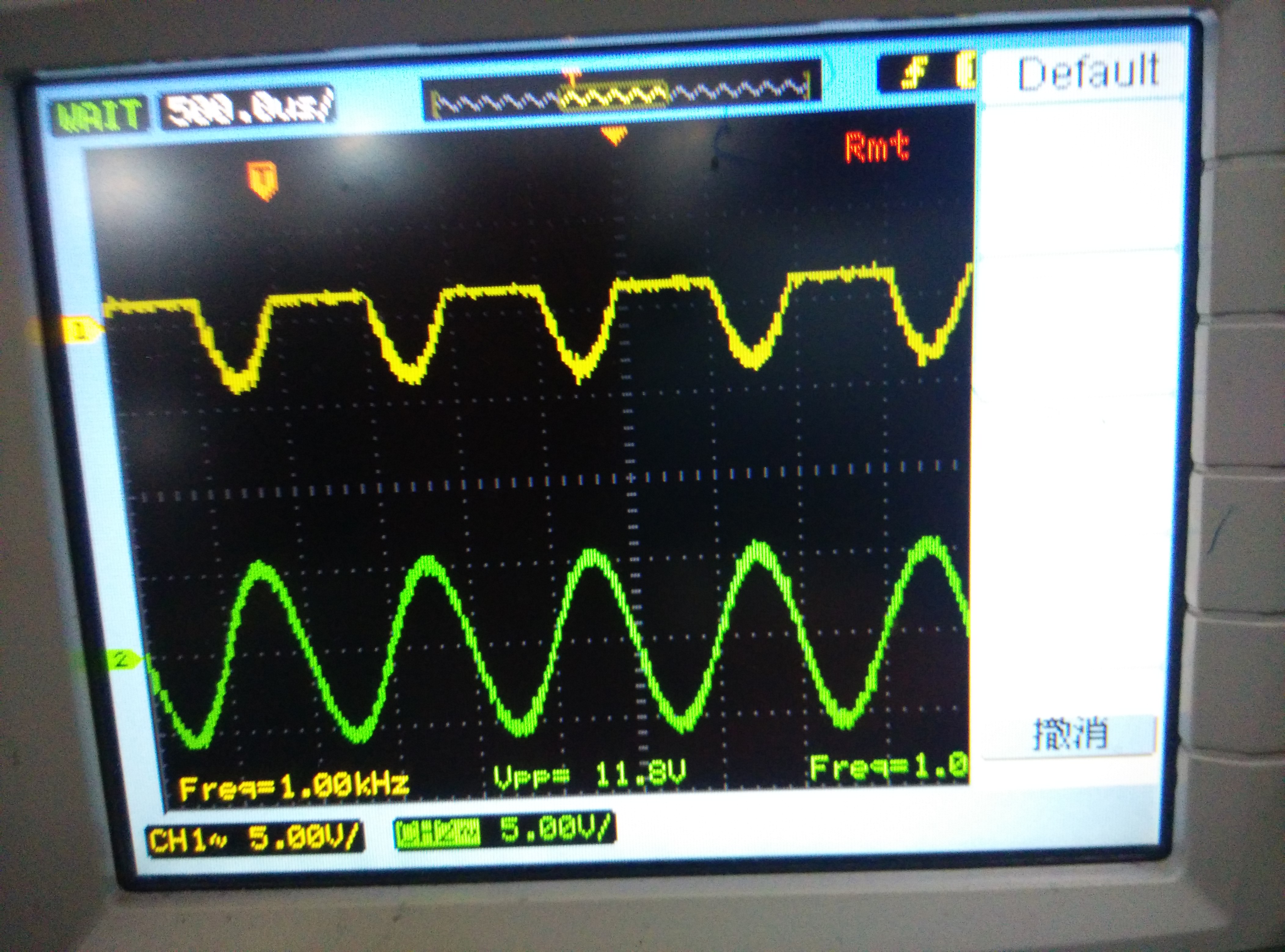

    I went to customer yesterday and confirmed the problem.
    There are two problems for 25 pin.
    1. output wave of 25pin(HPL) distort.
    2. 25pin and 26pin is short
    I did some test and confirmed that TLV320AIC3204IRHBR was broken. The reason still need to be investigated.

  • Hi GU,
    I'd recommend measuring at pin 25 with a scope to see transient voltage when plugging and unplugging to help determine the cause of the issue.
