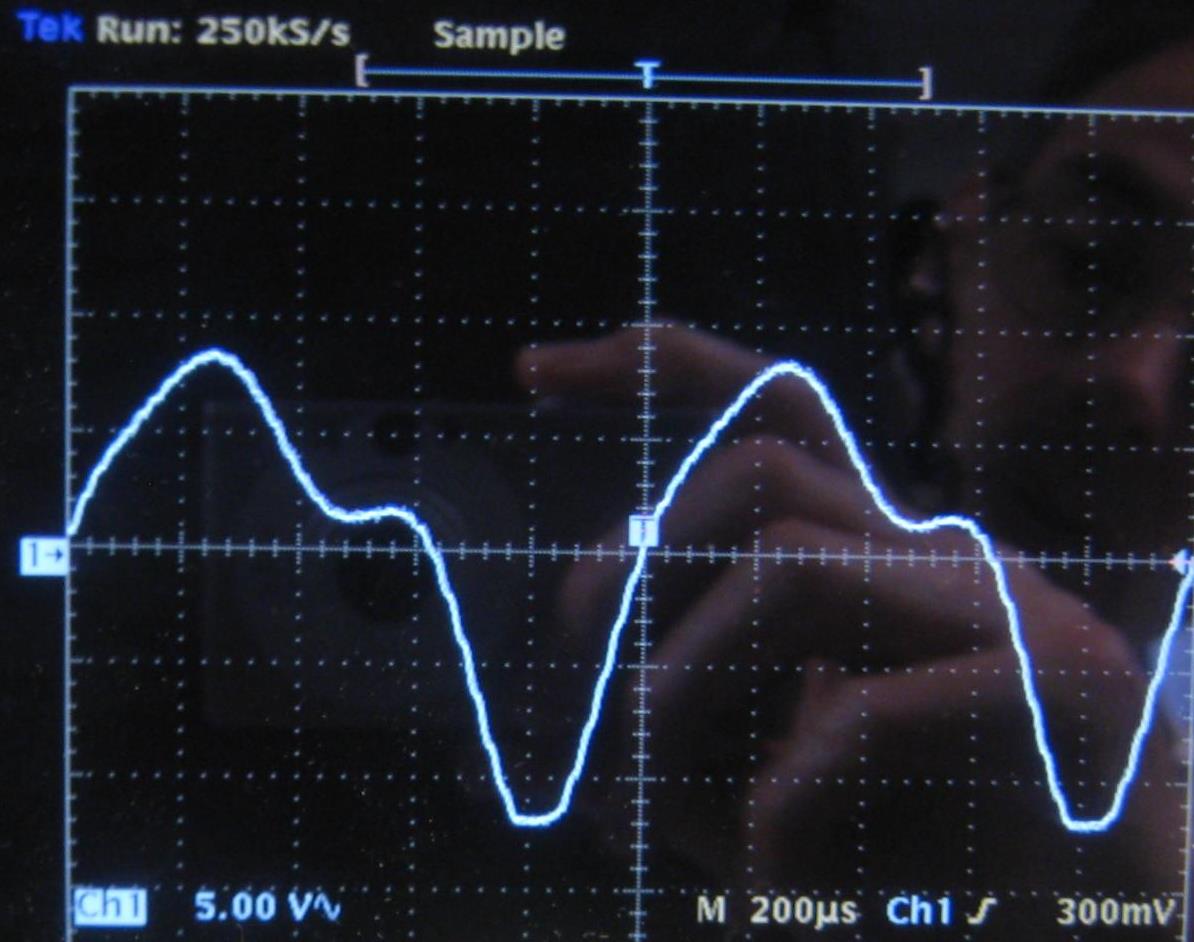

The device / circuit works as expected at room temperature.  It's in the 8-bit companded format.   Digital to analogue side works fine at all temperatures tested.   At high temperature the analogue to digital path shows little distortion as the temperature rises until it reaches some threshold (varies part to part, mostly around 70C but some as low as 50C).  Above that, distortion rises gradually with increasing temperature and becoming really bad (eventually to 100% as calculated by using FFT).   The distortion is visible just looking at the data with a scope (two codecs in parallel, heat one, see MSB go wrong on hot one).  Using another codec to convert back to analogue allows me to see that as temperature rises, the distortion worsens (I'll add images).  The problem is not sensitive to amplitude or to the exact shape of the clocks.  The problem is not new, however it seems to have got much worse this year.
  • Here are scope plots of the distorted digital PCM converted back to analogue.
    1st <1% THD (room temperature),
                                   2nd shows more distortion as temperature rises,
                                                                    3rd image shows 37% THD when hot.
    All inputs except temperature stayed the same.  For convenience in the lab the codec chip is being heated directly by a power resistor stuck to the plastic body, however I get identical results when the device is in the equipment in a thermal chamber, heated by the hot airflow, with the chip package temperature monitored.

  • We did eventually crack this problem.   The cause was current leakage through the reverse biased mic input protection diodes (which increased with temperature).  The designer had not appreciated the significance of the datasheet limit of +/-300nA max input bias current - it was probably assumed that this was a characteristic of the chip rather than a requirement of the circuit.   What I found is that although the differential input impedance may be per datasheet, the common mode input looks like an insulator.   An experiment indicated that the common mode input resistance was higher than our DVM!    How the input bias works is a mystery within the chip - it does work very well provided we don't cause more than 300nA to flow in or out.
    One reason the root cause eluded us for so long was that the input signal looked undistorted - the problem being caused was inside the codec chip.
    Simply changing the diodes to a low leakage type fixed the problem.
