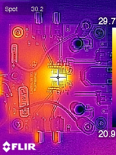

The TPA6120A2 seems to get quite warm even with no load and no or shorted inputs... on the EVM and on a prototype board I built. Checked for oscillations or big offsets, didn't find any.
The data sheet shows supply current of 30mA total, so that's 0.45W...
Just wondering if that's normal.
