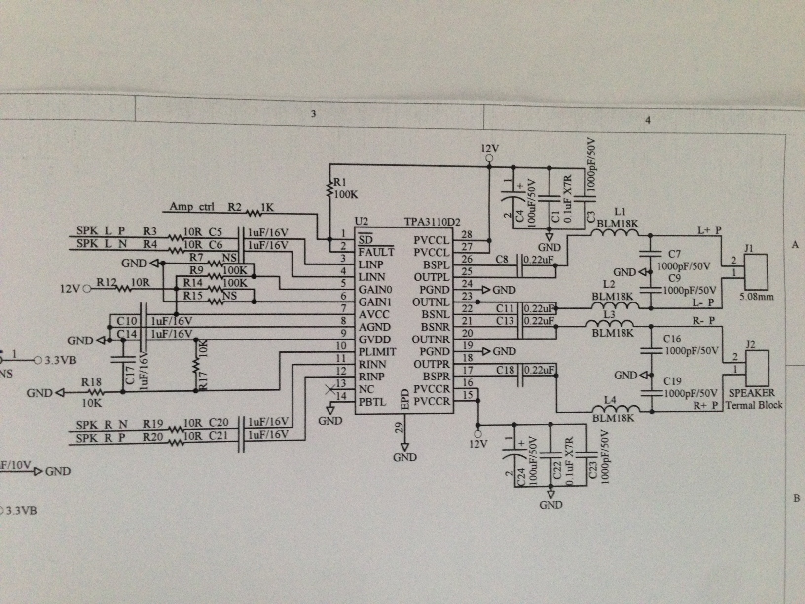

Can anybody from TI help with a problem that we are having with Radiated and conducted emissions on an amplifier that we have had designed for us. We are using a TPA3110D2 Chip  with a 12v supply.  We believe that we are achieving an 8 watt output into 2x  8 ohm speakers. One of the speakers has a cable length of 120 mm and the second speaker has a cable length of up to 10 meters.

  • Hi Tomasz,
    The design is without snubbers and is built as per page 20 of the Product folder ( july 2012) with FB=BLK18K . The speaker cable used is not twisted.
    Mark.
  • Hi Mark,
    If you like you can share with us some more details about your design so I could take a look.
    - what exactly type of ferrite bead it is
    - what types of capacitors you used - is also quite important for the EMI performance
    - how does your PCB layout look like? Could you post a picture to illustrate the output section of your amp?
    Tomasz

    you can send me all details at tomasz (at) chumiecki . com , its my private email. Weekend is coming so I can take a look on it - maybe we can find some solution. At the first look it doesn't look good :) Have you considered using a standard output filter section with real inductor, snubber and capacitance about 1µF? Placing a standard output filter + snubber + common mode choke would probably solve the problem - the question is how cost and space sensitive your project is.

    this is what I would suggest - replace the FB output filter with LC one, use snubbers, take a look on decoupling caps and in case of hard radiated emission problems use common mode choke on output.
    Tomasz
  • Hi Tomasz and Paul,
    This is a current drawing of the design
    I appreciate your help with this issue.
    regards
    Mark
  • Tomasz,
    The goal is to fix the problem ASAP with what ever we can taking into consideration cost and board size. Our subcontractor is not an expert in this field of amplifiers and EMi and is asking us for our input. We are trying to get it right this time with one more sample run as it is becoming very costly to keep on producing samples to continue to fail.
    Mark.
  • Hi Mark,
    sorry for the delay, I had a bit busy weekend what I didn't planed so ;) Lets summarize what we have now:
    1. what I understood up to now is that TI can not guarantee you can pass your CISPR13 EMI requirement with the simple ferrite bead output filer, and surely with 10m speaker cable... with this 10m long speaker cable I would be very careful with EMC performance...
    2. you could try implementing snubber, decoupling caps and optimize your your layout but... passing the test would be not guaranteed...
    3. your goal is to fix the problem ASAP with what ever you can taking into consideration extra cost and board size. Your subcontractor is not an expert in this field of amplifiers and EMI and is asking for an input.
    So my suggestion is:
    - to definitely replace the ferrite bead based filter with the LC one - I don't think would be a really cost driver. the PCB area will definitely grow...
    - simultaneously take a serious look on the PCB layout design in a way of EMI performance
    - put even some extra EMC relevant components footprints (like for common mode choke for HF) as an assembly option you can use them if needed, if not you can leave them not populated. Such an option you can use even being in the EMC lab, just to pass the test or to find the optimal design.
    Tomasz
  • If you like you can send me the layout/layout part to review. Your schematic looks like Protel?/Altium? schematic - I unfortunately use the CADsoft EAGLE for everything but we can find a solution if needed :)
    I can try to find for you the possible LC output filter configuration if you like. Even doing the amplifier PCB layout design for you would be possible, but I have to schedule such a task in my time :) In this case we have to contact and discuss some more details.
