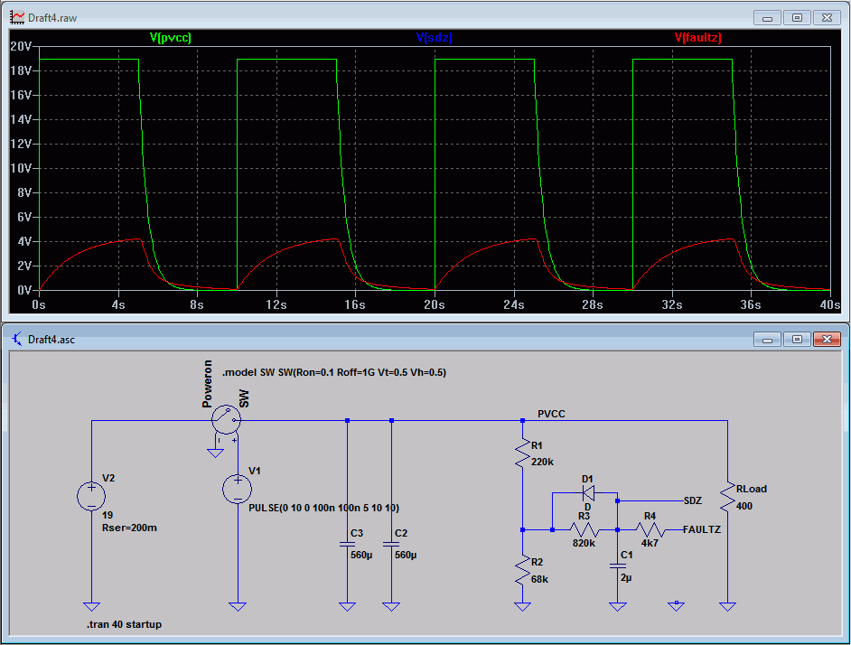

Hi all,
there are two questions about the TPA3132D2 at the moment which i can't get from the datasheet (which is wrong in several ways and figures).
How much current can the FAULTZ (OC) sink? (I.e. using a lv-led there -> PVCC -> R -> LED -> FAULTZ)
Secondly, how to avoid the anoying  power-on plop with ease. Is it enough the have a time-constant (RC) on the SDZ pin? If yes, is there a rule of thumb for the time, the chip needs to have everything setup?
Thanks in advance,
