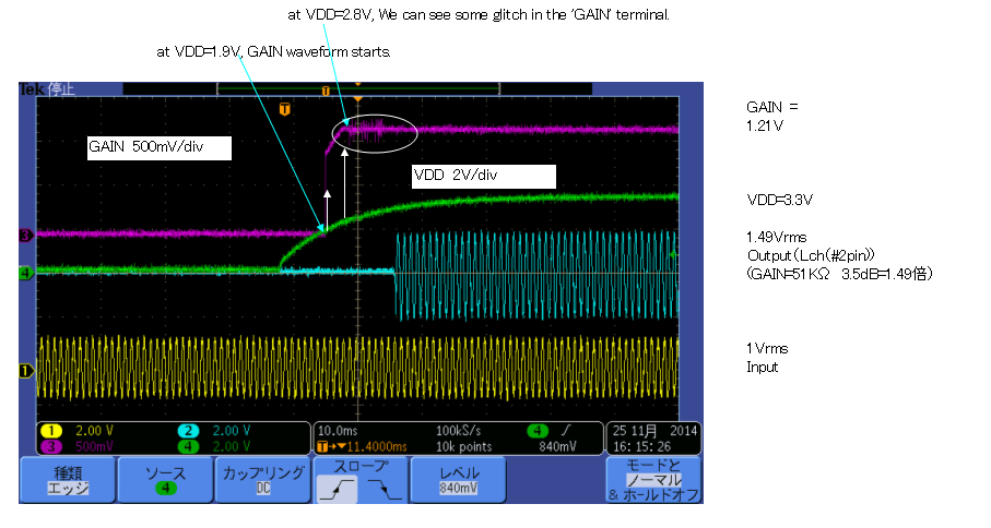

I had checked DRV612 EVM to compare the ' Fail ' sample ' (Gain= 16dB from customer's board )
and 'Good 'one  (Gain=3.5dB)  when Rgain=51Kohm.
Attached is the 'Good' sapmle (EVM) wave form.
We see some glitch ( internal circuit start up and seems proper operation for internal charge pump something )
 when Vdd is over 2.8V at  ''Good' sample.
Also, when Vdd is over the 1.9V , GAIN voltage goes up.
Here is the question.
Q1  Is these waveform  proper operation? ( Would you please check in  TI USA?)
      Customer had  found there are no glitch on GAIN terminal on ' Fail' sample on customer's board, but
     found glitch on 'Good' sample.
Q2  Would you please describe how DRV612 internal circuit works at the Power up for Gain-setting?
      I need more detail internal block diagram for DRV612 also.
Customer is using DRV612 for their STB from  a few years ago, but  they found  3pcs/1500pcs were illegal gain (16dB, all of 3pcs)
even Rgain=51Kohm.
I have doubt for customer's board( noise of Vdd line)
