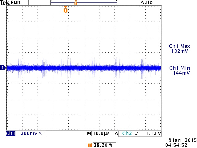

we are using the TLV320AIC32 Codec in order to generate audio for a loud speaker and noticed that some white noise was present at the output. After some investigation we discovered that the noise appears to originate from the codec DAC and is subsequently amplified by our gain circuit.
While performing tests, we observed that the noise is not present when the codec is initially configured and only appears once a non-zero digital input is supplied to the codec. Prior to the activation of the audio input, the noise level is measured at ~30dB less than what can be measured after audio has been applied and removed from the input. Changing the power state of the DAC (performing a power-down/power-up operation in the DAC Power and Output Driver Control Register) seems to return the DAC to the same level as after initialization, however using registers to momentarily disable the DAC is ill suited to the application in which the codec will be used.

Here is the output of the codec after configuration (or after a DAC power-down/power-up operation) :

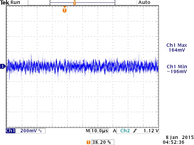

Here is the output of the codec after digital audio has been applied and removed from the input :

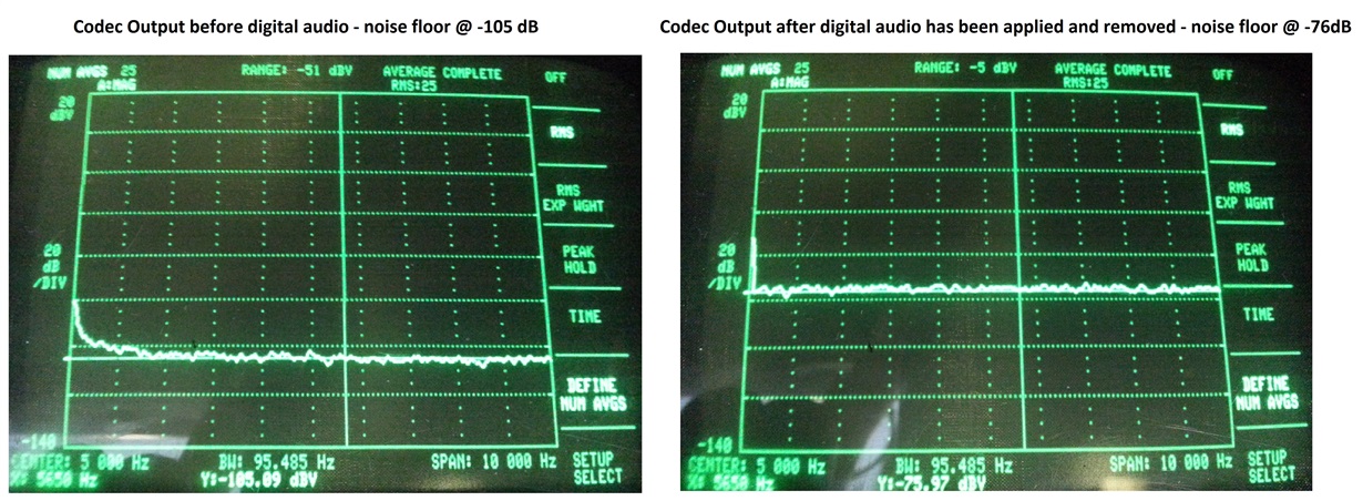

    the issue is that the output noise level from the codec increases after audio has been applied and removed from the output when compared to the initial noise level that is measured after configuration.
    As example, following power up the codec is configured and an output noise level of -105dB is measured, then after applying and removing digital audio input from the codec the noise level is now measured at -76dB (and a white noise is audible at the speaker). If the DAC is powered down and powered back up (register 37 : D7 & D6 - Left / Right DAC Power Control ) the noise level returns to -105dB until digital audio is applied to the input once more.
    Good News  :  in performing some tests, i've implemented a low pass filter at the output of the codec (recommended in SLAA313) which seemed to have improved the noise level (silence measured at  -93dB) and removed the white noise that was audible at the speaker.
    The only detail i would like to properly understand is how this 30KHz RC low pass filter is affecting the audible range (40Hz - 20KHz) and attenuating the noise at the output (we are configured for 8KHz sampling rate).

  • Hello Vincent,
    I'm glad to hear that you have found how to remove the noise. You can find the answer to your question in the document you describe (SLAA313), from page 3:
    "When a signal containing significant out-of-band noise is reprocessed by another component such as a PWM modulator in a Class-D amplifier, or another A/D converter, the out-of-band noise is modulated or aliased back into the audible band. For this reason, anti-aliasing low-pass filters are recommended between codec outputs and Class-D amplifier or A/D inputs."
