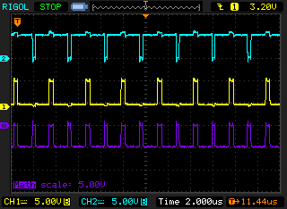

  • This is what a snapshot of the waveform looks like with a 4-ohm load (I couldn't find a large enough 8-ohm resistor).  Current is 1.5A average (and seems to be that no matter what my input is (same current if I'm playing the 1kHz sine wave versus if I don't have any input applied at all).

    Channel 1 is OUT- and Channel 2 is OUT+ (both measured with respect to ground).  Seems a bit odd to me that when I do the math (CH1-CH2 ... I know, technically it should be the other way around), that there is a dc-offset.  Not sure what it is supposed to look, but I would have expected a dc-offset of 0V.  CH2 looks suspicious.
  • Should also add that with no input at all, Channel 2 is at ~5V. Neither it nor Channel 1 toggle at all, with no input (and the current is constant, around 1.5A). Seems to me the one FET is stuck high.

    Probing at IN+ and IN- on the chip, with no input connected, I see that IN+ is at a dc-offset (presumably an internal bias) but IN- is stuck low. Shouldn't IN-, with no input, be biased to the same dc offset as IN+?

    It really isn't worth me attaching a plot, I can describe it pretty well. With zero input signal, I see no transitions at all. VOUT+ is stuck at 5V, VIN- is stuck at 0V.
    With an input sine-wave (1kHz, 1Vp-p ... though this detail doesn't matter because I can't really capture enough data with my oscilloscope to filter out the high-frequency switching components from the output to see a sine-wave, even if the amplifier was working), I see bursts of activity that are the same as the "zero-input state" I describe above, and bursts of activity that appear like the screenshots I've already attached (VOUT+ and VOUT- toggling between 5V and 0V according to some sort of varying pattern).

    I think the evidence that I've seen indicates this EVM (and the other one before it) have something gone strange with the amplifier. I have measured the IN- input (relative to GND on J1) between C9 and U1, and it is low ... I would have expected it to have the same dc-bias as IN+ measured between C10 and U1 (which appears, at least now, to be around 800mV with zero input). Because IN- appears to be "stuck low" rather than dc-biased to be equal to IN+ ... that creates a differential voltage at the input to the amplifier, and that dc-voltage then appears at the output of the amplifier ... hence the reason that VOUT+ minus VOUT-, even with zero input, is not a zero output.

    You are absolutely correct that the dc bias on IN- should be the same as the dc bias on IN+. The two things I would check here are if C9 is shorted for some reason. If not, then I would suspect ESD damage as IN- is connected to the shield on the RCA input which might be subjected to ESD strikes since it is the more exposed of the two inputs.
    Do both boards exhibit this same behavior?
    The inputs of this IC are rated for 2 kV HBM. Typical handling procedures in an unprotected environment can easily exceed this level. The usage case for this IC is to be connected internally in a final design, so these inputs are typically not exposed to the outside world (and ESD strikes).
