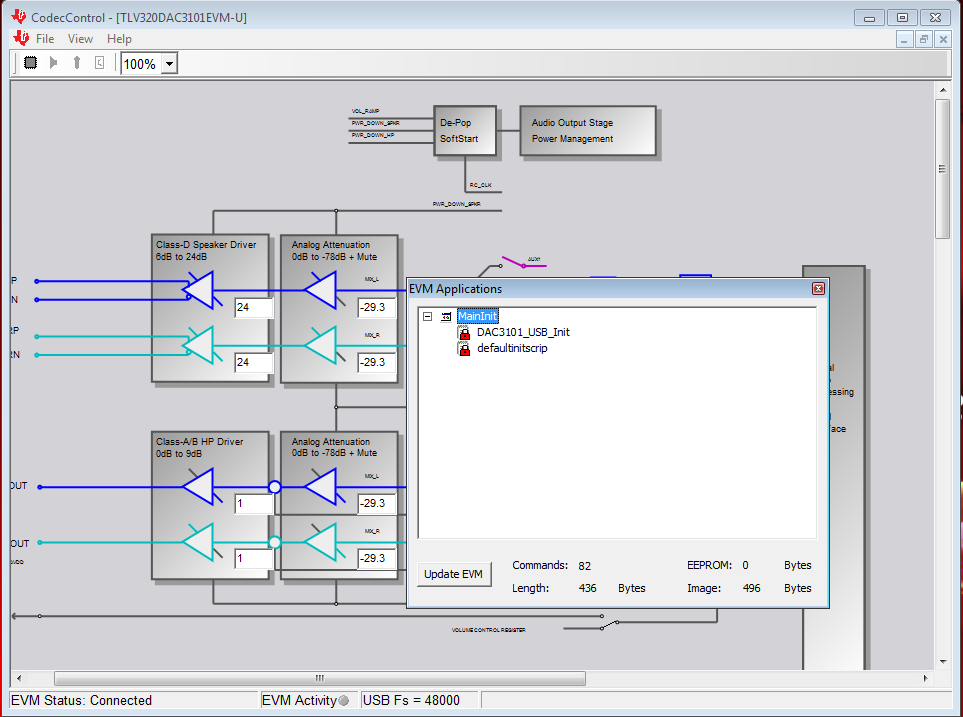

I'm trying to install an EVM application to configure the EVM board to be used as a sound card. I added the default Init-script to an EVM application, but when I quit the codec control software and replug the EVM board, it is recognized as a USB soundcard, but there is no sound output. Do I need to do any changes to the default Init script to get sound output on the Class D outputs?
While running the codec control software (slac366a) there is sound output on both headphone and Class D outputs, without any changes to the default setup.
