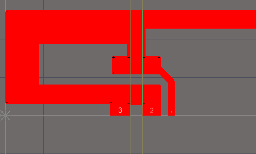

Missing dimensions on the DN0007 design note
After a whole day trying to import the DXF file included on the CC2430DB Reference Design to Altium Designer without success I decided to draw it myself following the dimensions specified on the DN0007 note.
After drawing the antenna body without too much trouble I noted that there are no dimensions specified for the two pins that connect to the ground plane. I believe that the missing dimensions are not critical, but just to be sure and and thus avoid wasting a prototype, I've made the first pad 1.35mm wide and the second 1.20mm wide with a separation between them of 0.8mm, I'm good to go with these dimensions?
Thank you.
