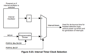

    1.The MCLK divider must be set such a way that the divider output is ~1 MHz for the timers to be closer to the programmed value. see below, the interval timer clock:
    For this, you can set different MCLK divider Page 3 / Register 16 (0x10): Timer Clock MCLK Divider as long as MCLK frequency <50MHz

    I would like to confirm the MCLK frequency.
    The divider output is should be set - 1MHz.
    In this case, can they set low frequency for MCLK (<1MHz)?
    I think they can use <1MHz (ex 500kHz, 20kHz and so on), because IC needs <1MHz for PLL.
    Is it correct?
    Atsushi Yamauchi
  • Dear Atsushi-san,
    Yes correct, there is no minimum value condition for the MCLK.
