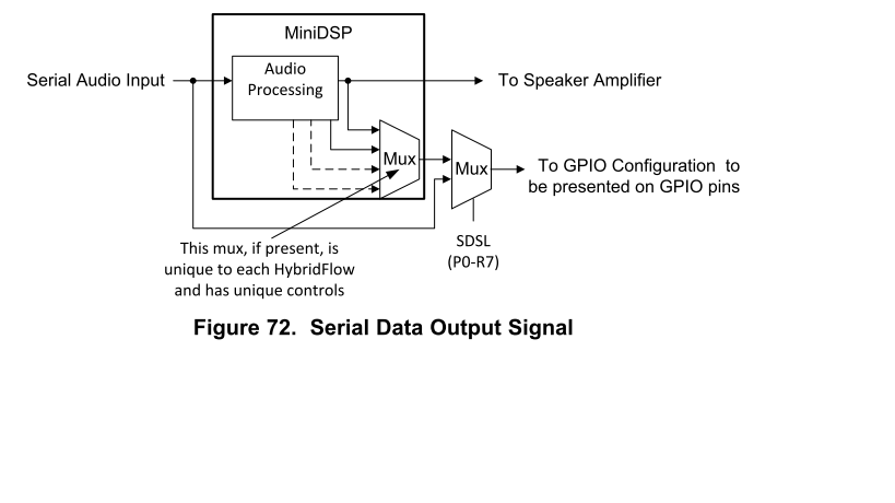

               I described my questions on TAS5754M. Per datasheet page 50, we would like to configure the signal to originate after a subwoofer generation block, which sums in the inputs and applies a low-pass filter to create a mono, low-frequency signal. This is first path. The second path is after audio processing block and the signal is applied to speaker amplifier. The volume of the serial data out (I2S) which after low pass filter and the speaker amplifier output can be separated controlled or not? Separate mute is possible or not for these two path? Due to we don't know HybridFlows how to work detail, so the questions are needed to clarify. Please refer to 8.3.3.7 Serial Data Output that datasheet describe.
