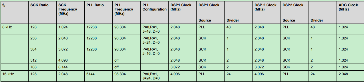

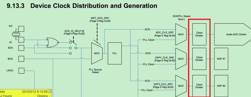

  • Thanks for your reply.And I still have some questions.We use PCM1865 as Master.
    1. Could we leave the dsp coefficients data default?We need to transfer four mono 16K audio to TI's dm8168.
    2.For the below picture,the clock dividers inside the red rectangle,which register corresponds to them?I can NOT find any register corresponding to them in the spec. And for the audio adc clocks, how to decide it? For our case,we need to transfer four channel 16K/16bit audio to TI's soc.then the audio clock= 4*16K*16bit=1.024M?Right?
    3.what does the SCK ration mean?It often appears in the spec.
    4.For the below picture,What does the clock dividers in the red rectangles mean?
    For register 0x026, from the diagram, it is the "master sck" to bck ration,and the so-called "master sck",in fact, is PLL clock after the clock divider in the green rectangle,or sck.
    For the register 0x027,is the BCK to LRCK ration, for TDM mode,should be 255.But in the register description part, it says that it is "Set the Master SCK Clock Divider value"
    For different parts of the spec,the description for register 0x026 and 0x027 are different.For example, register 0x026.In Table6 PLL configuration table,it is master mode sck to sckout ration.However, in the register part, it says that "Set the master SCK clock divider value.This is ratio of Master SCK to Bit Clock(BCK)".
    For register 0x027.In the register part, it says that "Set the master SCK clock divider value", We do NOT know the exact meaning.However, in the clock tree disgram, it appears that it is the ration of BCK to LRCK.And in the Table6 PLL configuration table,it is "Master Mode SCK to BCK ratio".
    I am totally confused about the register meaning.
    My understanding is right?For the clock divider inside the green rectangle, it corresponds to register 0x025?

  •  Hi,TIer. The last problem.
    For the adc clock in the below diagram, how to decide the adc clock?How to get it ?
  • Hi SuitJune,
    This is explained in the data sheet in Figure 29. PLL Clock Source and Clock Distribution.
    Justin
  • I think it can refer to table 9,10,12,13 in RevC datasheet.And the principle is ADC should be fast enough to "sample" the audio.
