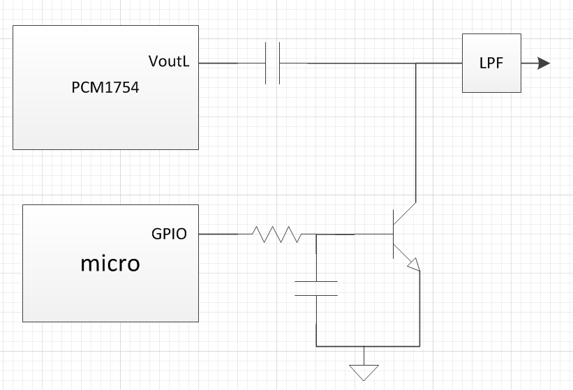

We are facing Pop Noise with PCM1754.
Noise occurs during beginning and end of playback.
Any suggestions?

Hi Saurabh,
For this part the best way to eliminate this pop is to have a microcontroller that would control a circuit to "gently" mute the output. This would consist of a GPIO connected to a low pass filter then to a transistor, that will be a path to ground for the audio out. this will provide a smooth transition from one state to another. you can have the LPF on either side, this is just an example of a solution for this problem.

Hello Justin,
Thanks for reply, We will try to modified the hardware.
