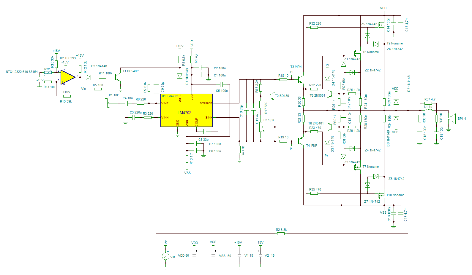

Hello Dear Members of TI E2E forum,
I'm projecting a power amplifier using TI's LM4702, and I need thermal protection and S/C protection for the output transistors.
I've made this design, but I don't know if it's the best solution.
There's any TI part to protect class AB output stages and speakers like TA7317?
