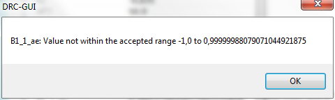

I would like to use a DRC module, but while configuring it, some warning messages appear.
The first one (when I double click on the DRC module to access to the configuration):
Despite of the value is in the range in the right panel...
Then, I get a french message (I'm french!) saying the format of the input string is incorrect and the pre defined default tamplate will be load. This message appears quite often!
Then, when I ended fighting with the errors messages and try to apply my settings, I get a new popup (in french too): StartIndex can't be lower than zero.
Moreover, I always need to replace the "." (point of the numeric pad) by "," (comma) to avoid some error messages.
