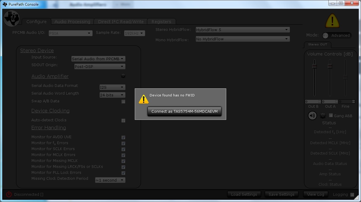

TAS5754M Can't Run HybridFlow 5
I have  some  questions about using HybridFlow 5
1.) I use PSIA Interface with sample rate=192kHz
    At No HybridFlow Condition,I can heard sound very well. After select HybridFlow 5 and Run, It will Disconnect and Show"Device found has no FWID"
    How could I use it?

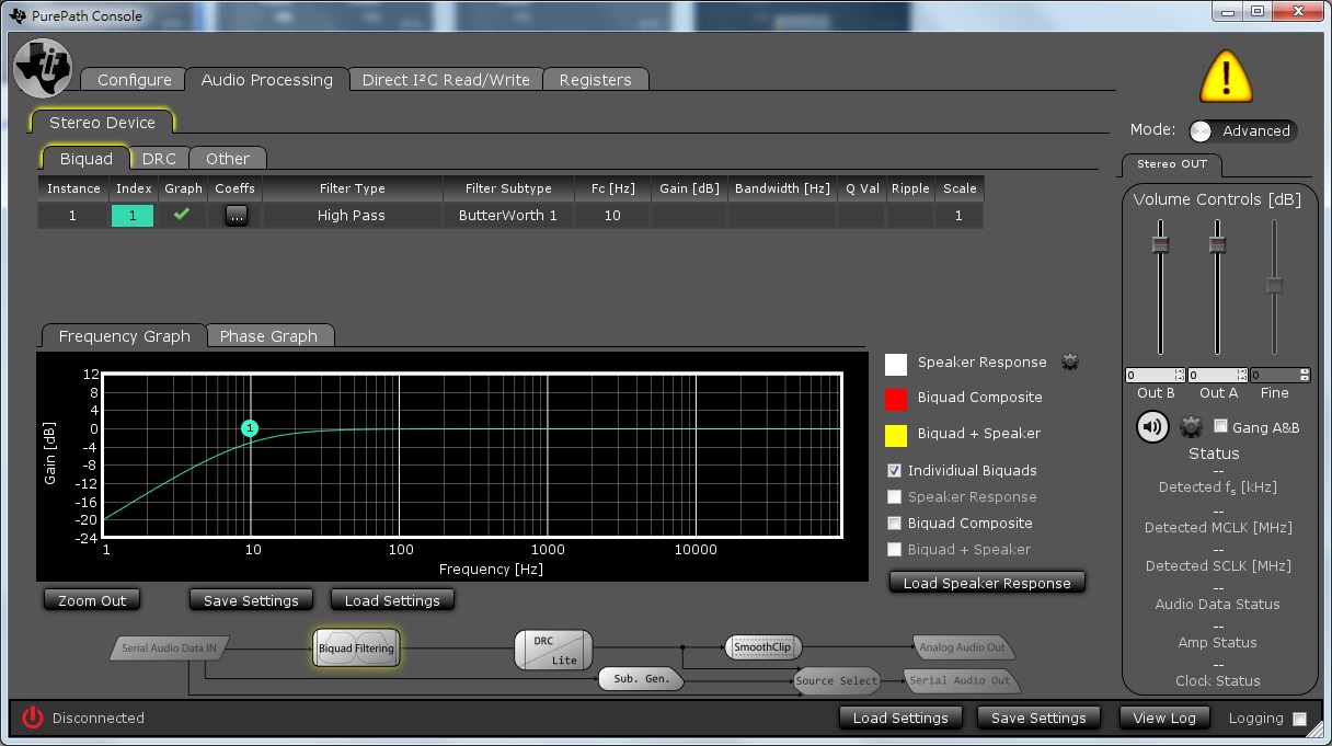

2.) In HybridFlow 5 Setting, It's seems only one Biquad could be use?why?

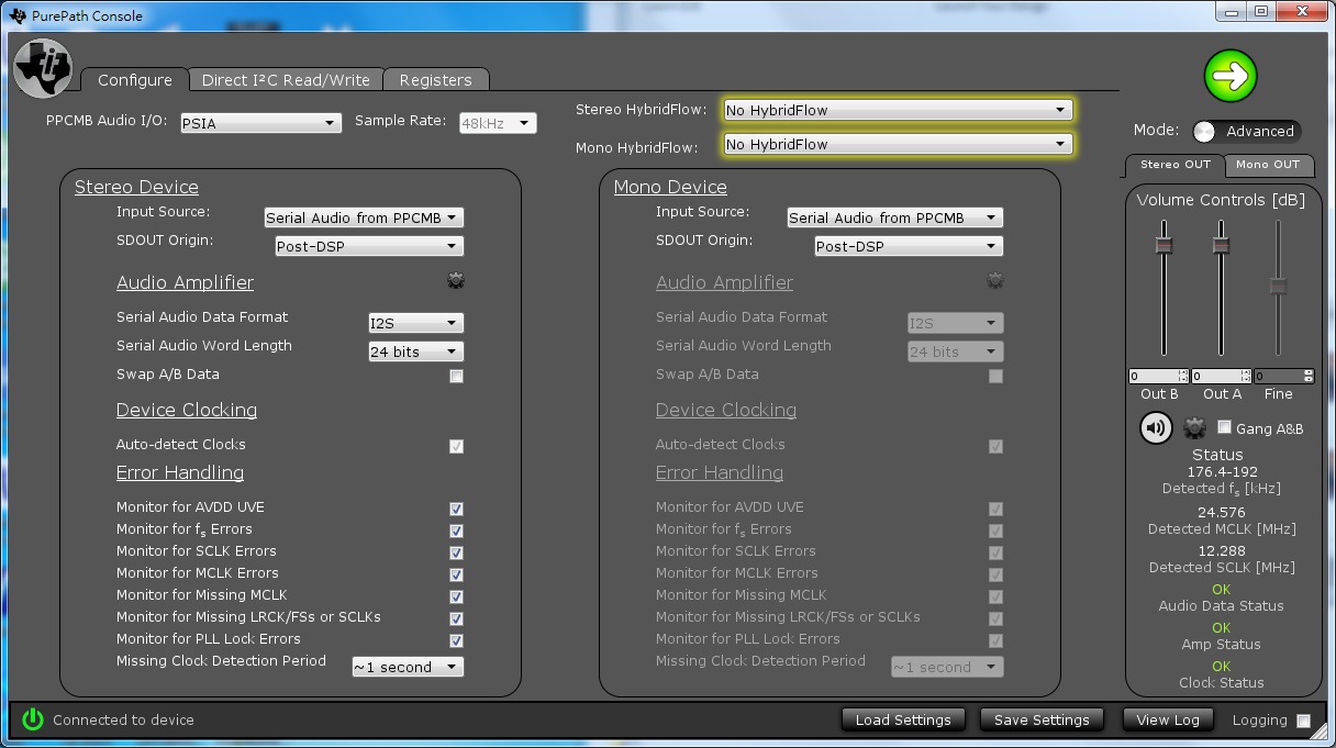

    There may be an issue with your setup. Does this only happen with HF5? What happens if you select HF1? It seem like the GUI didn't connect to the EVM and PPCMB properly, else it would say connected to TAS5754M-56MDCAEVM. Is the power supply on the EVM turned on and set to voltage >8V? Do you have another PPCMB you can try using with the EVM?

    Yes, It's only happen with HF5(sample rate=192kHz).

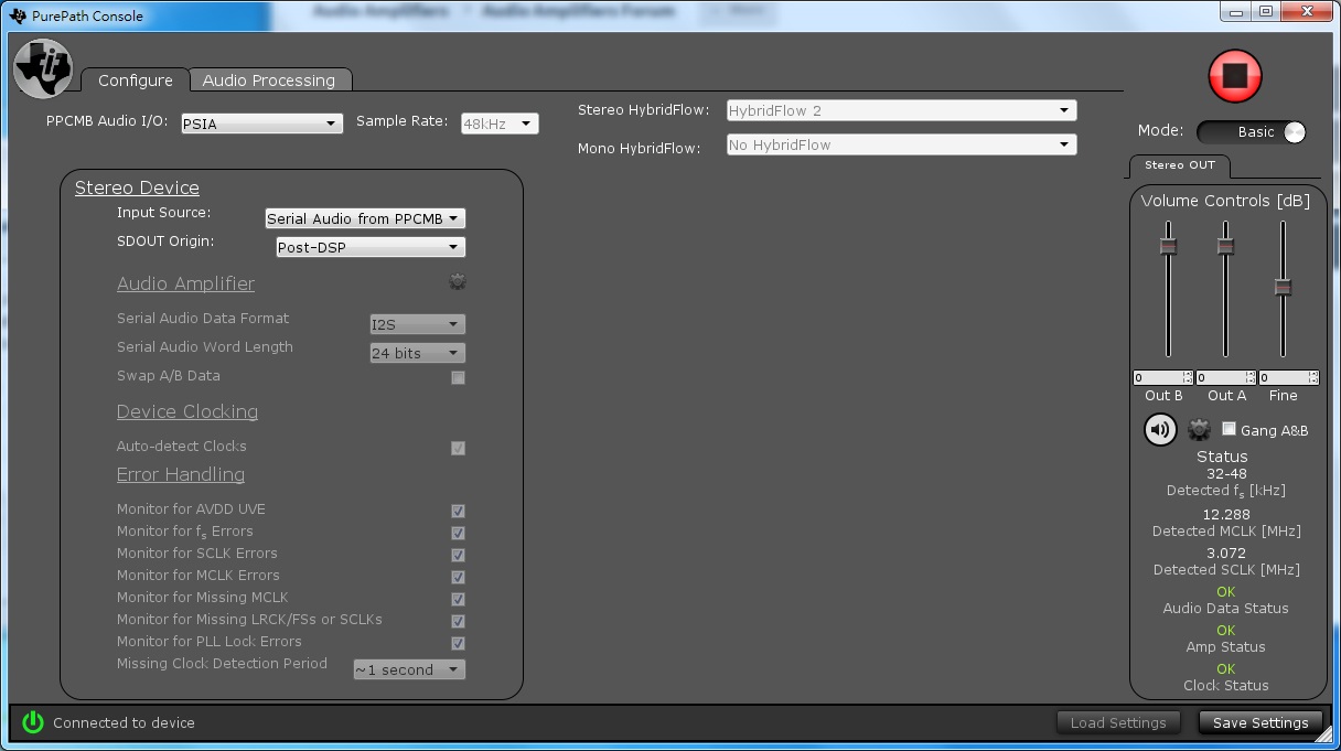

    I have tried HF1 & HF2 with PSIA Interface(sample rate=44.1kHz), and i can heard sound very well.

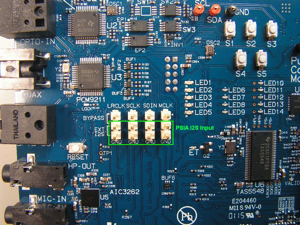

    My PPCMB Setting as below, Did i miss something?
