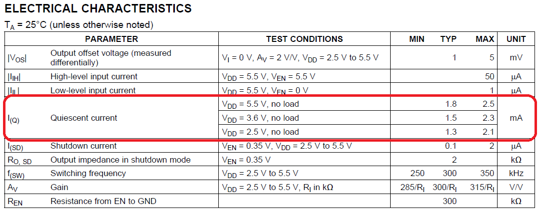

TPA2011D1 might be damaged since the quiescent current was approximately 300mA when our customer evaluated it with the test board.

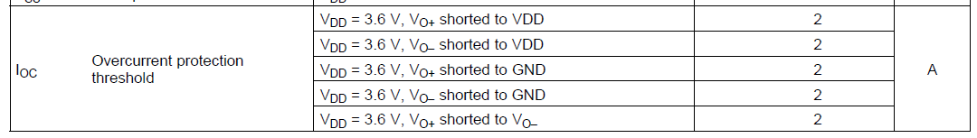

Is this part damaged by the short circuit although it has the overcurrent protection as below?
Could you please give us your advice if there is the other cause?
In addition, could you please tell us the detection method(cycle by cycle, etc) about the overcurrent protection?
