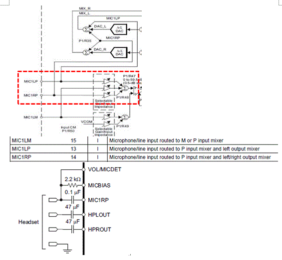

I have a question and request of your comment below it.
1.How about Condenser MIC(+,GND) of Single end type connection MIC1LP or MIC1RP ?
I think,MIC1RP is better then MIC1LP.
And, How about connection is MIC1LM pin? (ex)CAP(1uF) and GND.
2. We’ll Volume control is I2C of CPU.
How about connection of VOL/MICDET pin?

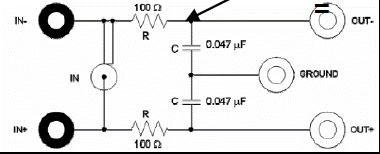

3. We’ll checking SPKP, SPKM output wave of scope equipment.
Please send me Filter method or schematic information.

4. Please review 1st schematic.
AIC3100_150309.pdf
