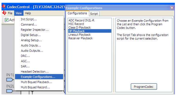

My customer has some issue by using AIC3268.
When he only uses example playback, the function is working. (like the following figure)
When he download miniDSP code (see the attachment iis_bypass), then execute the playback example code(mark the first the row about reset setting),  playback function is not working.
When he download miniDSP code (see the attachment iis_bypass), then execute the playback example code(do not mark the first the row about reset setting), playback function is working. But MiniDSP seem to be reseted.

The miniDSP will effect the common register (about playback register)?
Is the miniDSP code and playback register independent?
Could you do me a favor about the issue. Thanks

  • Nat,
    Two things.
    First, the device can operate in two modes: fixed processing and programmable mode (miniDSP). PRB modes PRB_P1 to PRB_P25 are fixed, while PRB mode 0 is programmable. When loading the script from the CodecControl software, it changes the mode from programmable to fixed which causes the issue.
    Second, you are using the AIC3262 software. Some registers might be different for AIC3268.
    My recommendation is to configure the device in PurePath Studio by modifying the SystemSettingsCode directly as explained in this wiki: e2e.ti.com/.../2777.modifying-the-device-configuration-of-a-pps-process-flow
    Example scripts for the TLV320AIC3268 can be found here: www.ti.com/.../slac654
