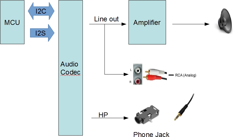

Dear Sirs
I want to use codec for the following two functions:
I2C control interface and I2S audion interface,
one line out and one HP=>What kind of codec do you suggest ?
two line out and one HP=>What kind of codec do you suggest ?
BRS
Nat
  • Hi Nat,
    You can use the Codec TLV320AIC3104, it is a very low power stereo audio codec capable of addressing your requirements. However, if you want to know more about these codecs (such the power consumption, sample rate, resolution and price), you may take a look of  Page 41 (Selection Guide) of Audio Guide.
    I hope this helps you. If you still have questions about it, please let me know.
