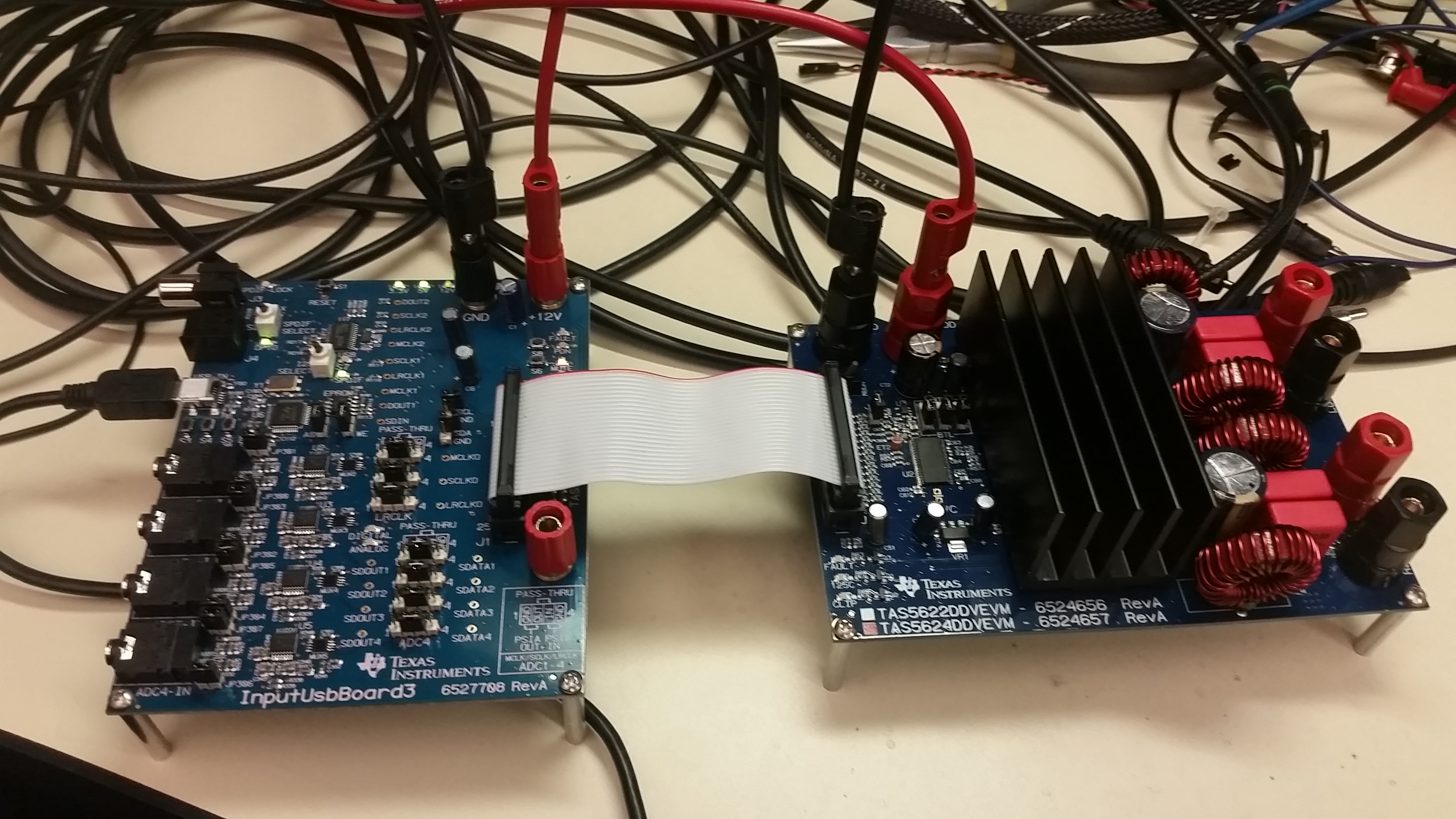

  • Hi Hasebe-san,
    I have tested the EVM and have no issues connecting to the TAS5548/58 GUI of PPC1.16. Is your customer using the latest revision of the EVM? (See picture below)
    If not, then which EVM are they using?
    If they are using the EVM pictured above I would advise them to re-install PPC1.16 to ensure they have the latest version

  • Hi Hasebe-san,
    I do not think the Revision of the EVM is the issue as I am using RevA (seen in my earlier picture). Are you able to send me a picture of their test setup? And let me know what voltage levels they are using to power each section of the EVM?
    Did you verify that the TAS55xx_GUI was actually writing to the device? I do not think the device is connecting like you think as my device says it is connected to that GUI but I cannot write to the registers with that GUI.

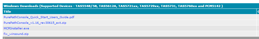

  • Hello Mike-san,
    Thank you for your reply.
    I found a cause that customer's EVM cannot be connected by PPC.
    The cause was to USBDriver and the firmware has not been changed.
    I heard USBDriver and Firmware how to change from Maruyama-san was contact the customer.
    As a result it has been successfully connected.
    TAS55xx_EVM and PPC of USBDriver and Firmware is different it seems a problem occurs.
