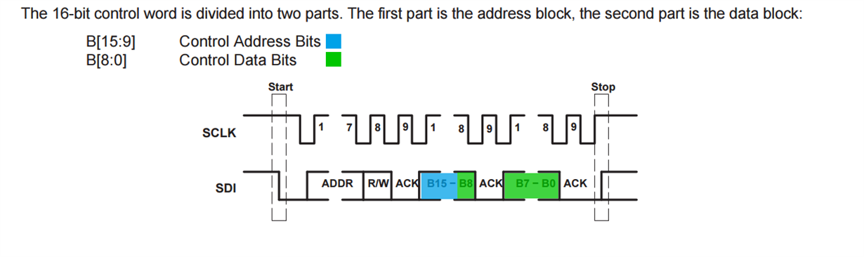

    In additon, On page 20, Section 3.1.2, there is a sentence as follow; The TLV320AIC23B is a write only device and responds only if R/W is 0.
    Is that mean that I can not read any of the internal registers of the TLV320AIC23B ? Am I right ?
    Do I need to arrage a 9bit I2C communication ? the registers of the TLV320AIC23B has 9bits. But the register addresses has 7bits. I'm a little bit confused. Can you clearify the I2C communication?

    Yes, as datasheet says this is a write-only device. About I2C communication:
    General I 2C Operation
    The I 2C bus employs two signals; SDA (data) and SCL (clock), to communicate between integrated circuits in a system. Data is transferred on the bus serially one bit at a time. The address and data can be transferred in byte (8-bit) format, with the most significant bit (MSB) transferred first. In addition, each byte transferred on the bus is acknowledged by the receiving device with an acknowledge bit. Each transfer operation begins with the master device driving a start condition on the bus and ends with the master device driving a stop condition on the bus. The bus uses transitions on the data pin (SDA) while the clock is high to indicate a start and stop conditions. A high-to-low transition on SDA indicates a start and a low-to-high transition indicates a stop. Normal data bit transitions must occur within the low time of the clock period. The master generates the 7-bit slave address and the read/write (R/W) bit to open communication with another device and then waits for an acknowledge condition. The slave device holds SDA low during the acknowledge clock period to indicate an acknowledgment. When this occurs, the master transmits the next byte of the sequence. Each device is addressed by a unique 7-bit slave address plus R/W’ bit (1 byte). All compatible devices share the same signals via a bidirectional bus using a wired-AND connection. An external pullup resistor must be used for the SDA and SCL signals to set the high level for the bus.
    So the address of the device can be 0x24 or 0x36 (7bit address + R/W' [0]).
    Regarding the register write, the 16 bit word is composed by the seven bits of the register address and the 9 bits of data as indicated in D/S:
