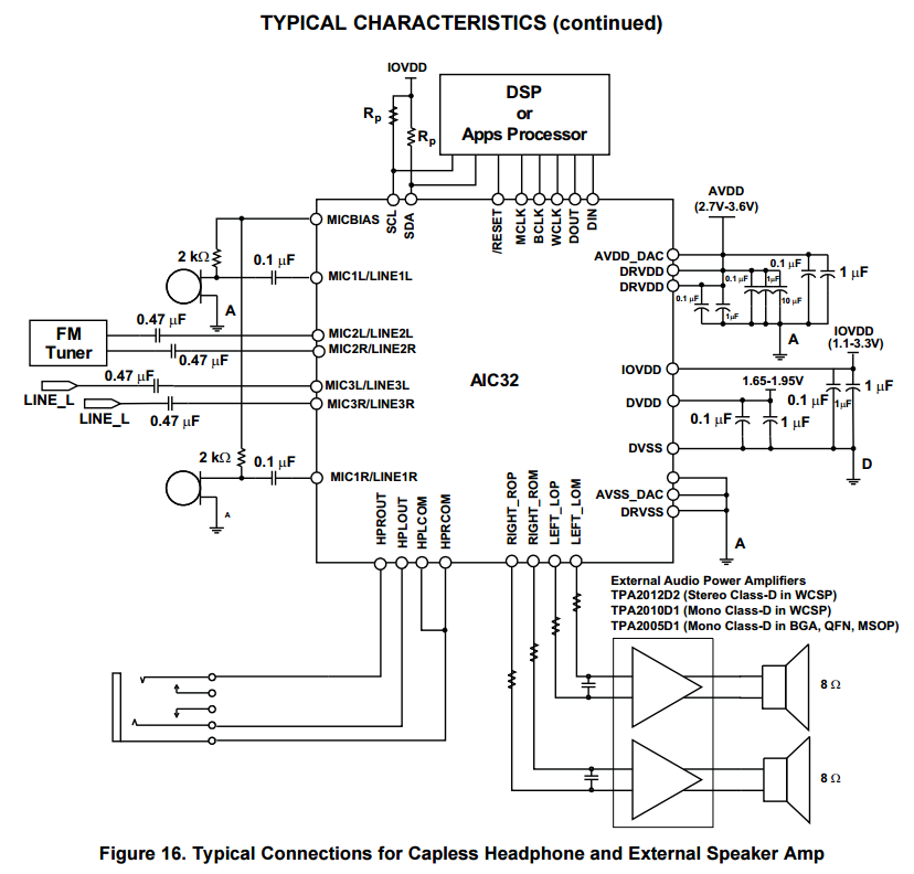

I am planning to connect a Stereo Headphone (RL=16 ohms) to the high-power HP outputs on the TLV320AIC3101.
I looked at the TLV320AIC32 datasheet. In Figure 16, it shows the HPxCOM pins tied together (connected to the barrel of the audio jack).
Is this the proper high-power capless configuration I can use with the TLV320AIC3101 to output at least 100mW from both HPxOUT's?
Thank you kindly for your help in advance!
James

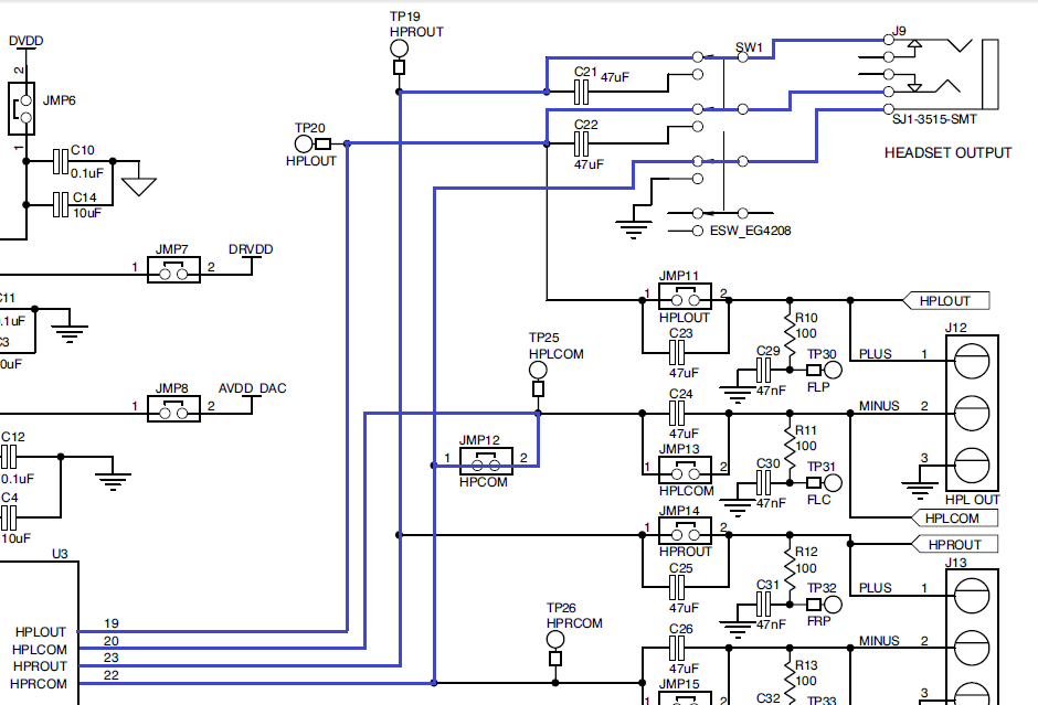

  • Hi James,
    Yes, you can use this configuration with the TLV320AIC3101.
    Additionally, you may see the TLV320AIC3101EVM Schematic if you need more information about your design. The TLV320AIC3101EVM has a switch (SW1) and a jumper (JMP12) that can be used in order to change between a capless and an ac-coupled configuration. You may see the next picture to better comprehension (the blue path shows the capless configuration).
    I hope this helps you. If you still have questions, please let me know.
    Luis Fernando Rodríguez S.

  • Hi James,
    Yes, the capless configuration allows to have a maximum output power with less THD, as datasheet mentions. It allows to have the output signal with a programmable common-mode voltage. It will let you have your power requirements.
    I'm glad to read that the schematic helped you. If you still have questions about the high-power capless output pin configuration for stereo headphone, please let me know.
