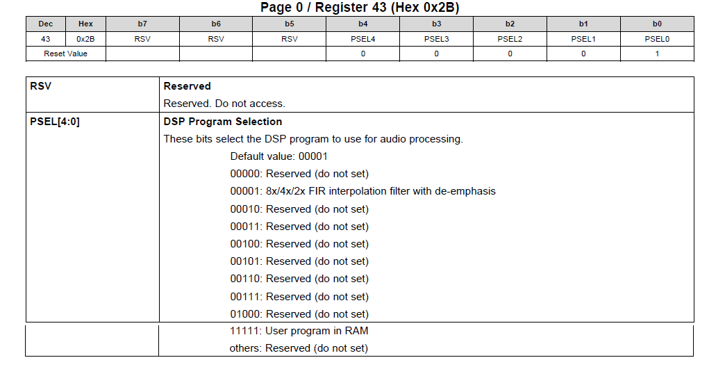

    Additional information about Step 6 : add 0x2B.
    ・When Step-6 : add 0x2B set to  data "0x1F", a sound doesn't come out.
    ・When 0x2B changed "0x1F" to "0x01", and StandbyMode was made Off⇒On, a sound came out again.
    ・The timing by which data of 0x2B influence is standby-OFF/ON, is it correct?
    Please let me know a relation between Page 0, 0x2B (DSP Program Selection) and standby.
    Satoshi

    The script below will perform a software reset first. This ensures C-RAM is completely reset to its default state which is required for DSP Mode 1. Running this script should result in audio playback every time if I2S is present. Let me know if this works always and then we'll proceed with the second part of the issue which is the User Program.
    # Reset
    # Select Page 0
    w 98 00 00
    # Set the device into Powerdown
    w 98 02 11
    # Reset Device
    w 98 01 11
    # Sleep
    # Select Page 0
    w 98 00 00
    # Set the device into Standby
    w 98 02 10
    # Select DSP Mode 1
    # Select Page 0
    w 98 00 00
    # DSP Program = Mode 1
    w 98 2B 01
    # Wake
    # Select Page 0
    w 98 00 00
    # Wake from Standby
    w 98 02 00
    J-
