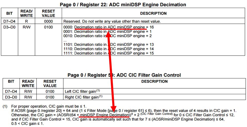

Hi Everyone,
Please let me ask about how to set CIC gain. Our customer ask how to set CIC gain to 0dB with following situation.
  • AOSR = 64

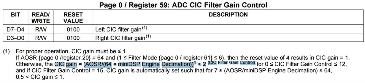

  • Processing Blocks = PRB_R7
I understand that the CIC gain can be calculated with following formula, so I think "miniDSP Engine Decimation" and "CIC Filter Gain Control" should be set. Please let me know if you need more information to set it.
