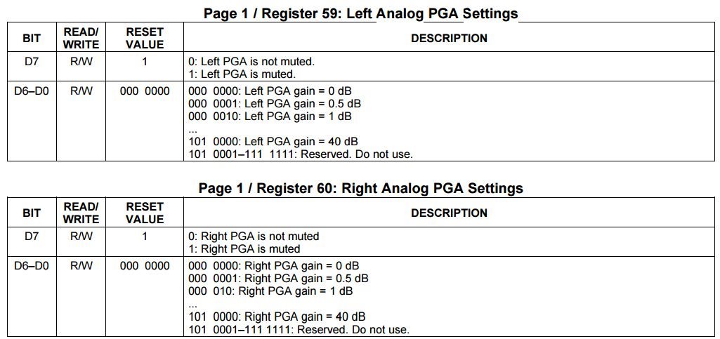

Hi Everyone,
Please let me ask about Analog PGA Settings (Page 1 - Register 59/60).
Is this setting active when AGC enable?
Sonoki / Japan Disty
  • Hi Satoshi-San,
    The PGA setting from the user side is not required when the AGC is enabled, because it is automatically modified. from Datasheet:
    "In AGC mode, the circuitry automatically adjusts the PGA gain as the input signal becomes overly loud or very weak, such as when a person speaking into a microphone moves closer to or farther from the microphone."
      -Diego Meléndez López
