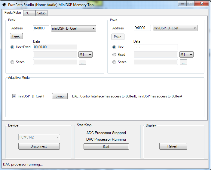

    You can try this yourself in PPS by going to the I2C Memory Tool.. in the Tool menu.
    Then go to the I2C tab. And select your base program for the desired sampling rate for the I2C Command File. Hit Execute for the program to be downloaded and run on the PCM5142 EVM.
    After confirming it is running correctly, you can then select a patch file with different biquad settings at the same sampling frequency. Hit Execute and the code will be programmed to the unused C-RAM buffer for the DSP. Then go to the Peek/Poke tab and hit Swap in the adaptive mode. This will swap the C-RAM buffers, and therefore the Biquad coefficients running on the DSP. You should see an immediate change in the output to reflect the new biquad settings.
    You will now be able to quickly swap buffers to see the effect the different biquad settings have on the output. This will continue until you write the patch coefficients to the other C-RAM buffer.
