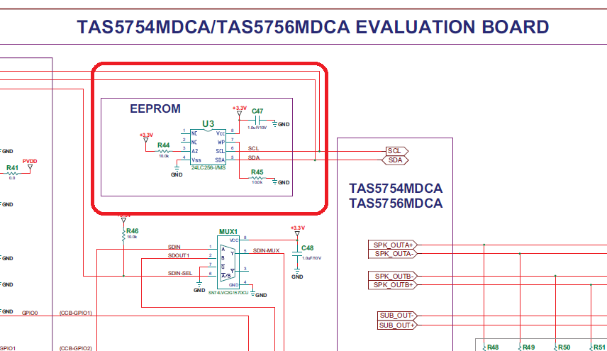

Could you please tell us the role of the EEPROM which is mounted on the TAS5754M/56M's evm ?
Kato
Kato
Hi Kato-san,
The EEPROM is for our GUI to identify the EVM connected to PPCMB board.
